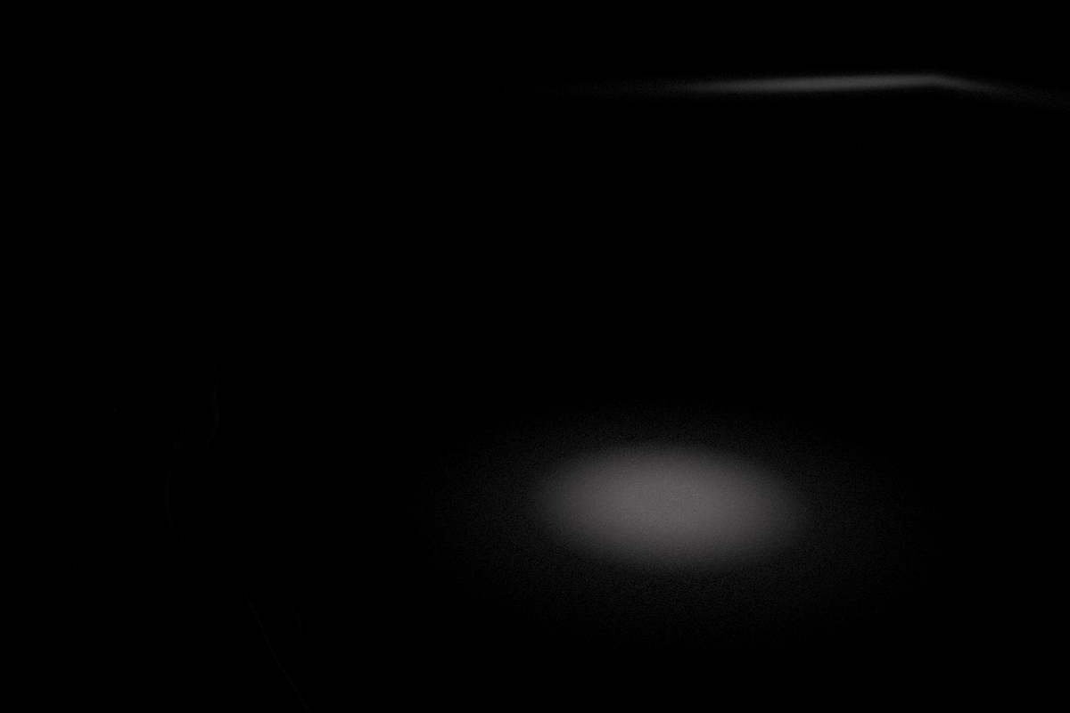

    So the effect you want to get is like the attached screenshot ? This sort of head light and street light ?

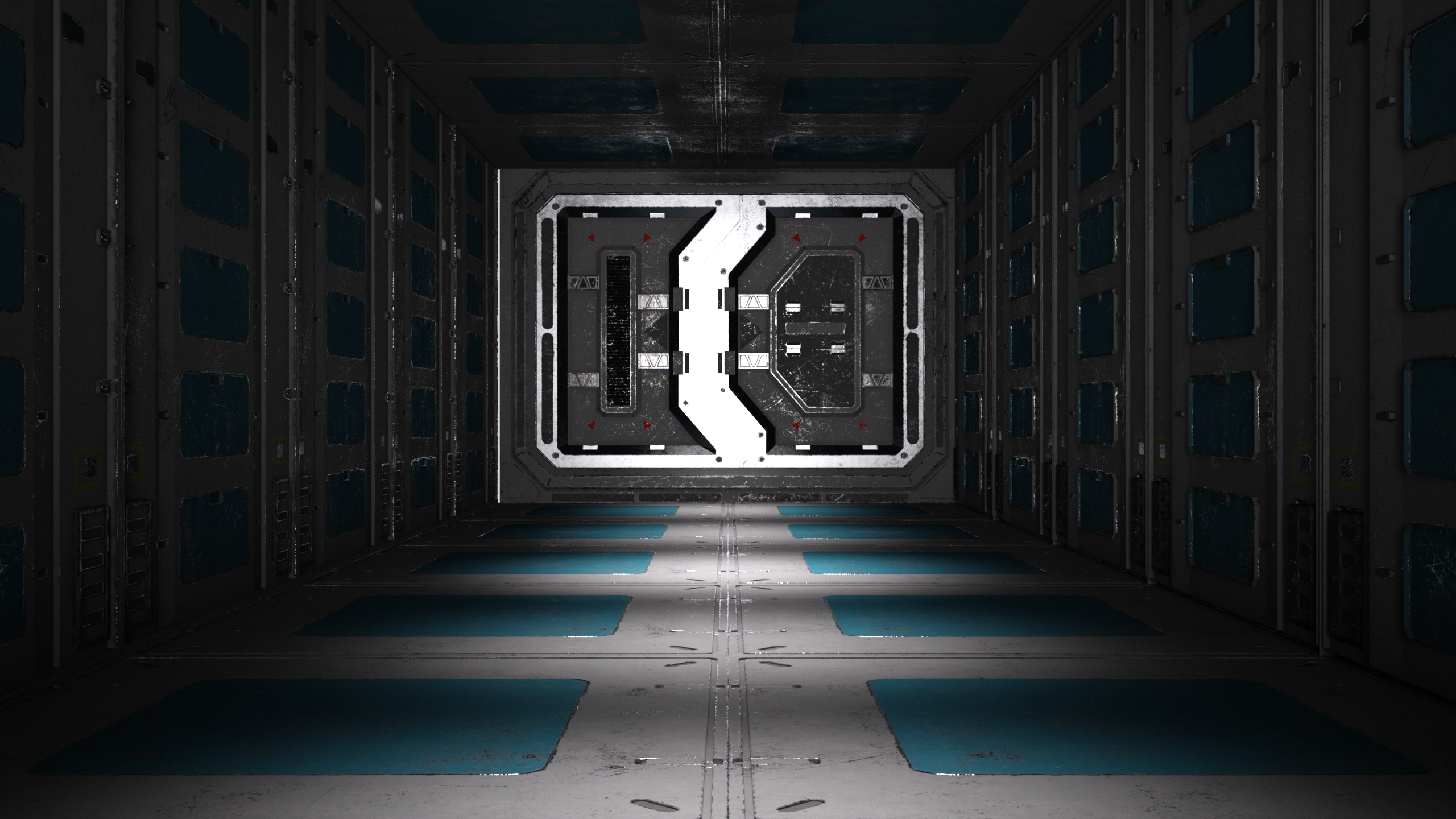

    This sounded like an interesting idea, so I thouht I would give it a try.
    Here is a test I did using spotlights in a hallway. I set the 3rd light's brigtness at twice settings for the other lights. It's noticably brighter but the area that is lit is the same.
    In this render, the spotlights are set as disc lights with a diameter of 100. Render emitter is off, and the Luminous Flux is set at 250000 except for the third light, which is 500000.
    Since this is an indoor scene, I put a large rectangular light at the end of the hallway to provide just enough ambient lighting to bring out the other details.
    2560 x 1440 - 4M
    Yes! that circle shaped light is exactly what I want but I don't want the light to spread too far when I increase the luminance.
    Yeahh that is basically what I am looking for, thanks for that. Is that possible with like ghost lights?, or only possible with Spotlight?

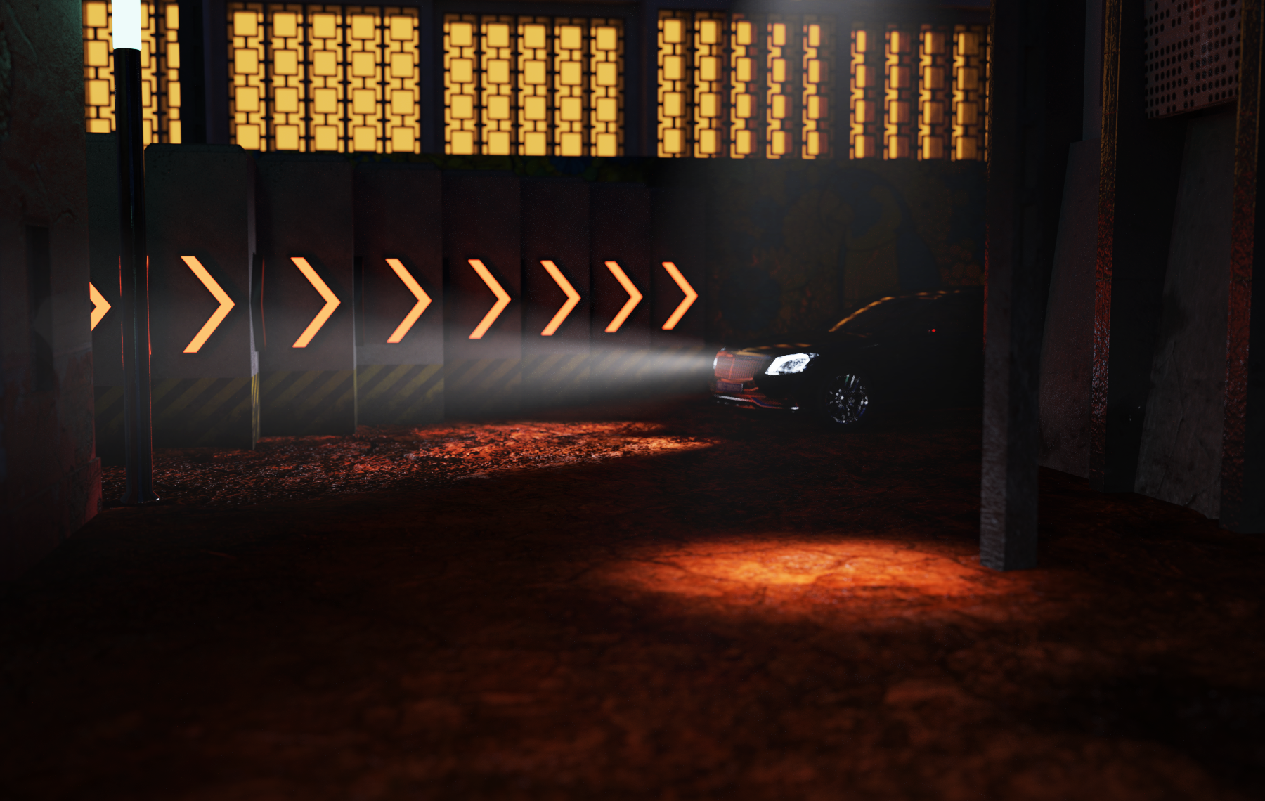

    Then I can only see that the OP must use something that limits the lightspread.
    Here I have put the lightsource inside a cylinder.
    1200 x 800 - 291K
    Post edited by felis on
  • FishtalesFishtales Posts: 6,238
    Funnily enough that was one of my thoughts to. Stop the spread and channel the light :)
  • ShadowzShadowz Posts: 48
    That is a pretty good idea, I'm going to experiment that
