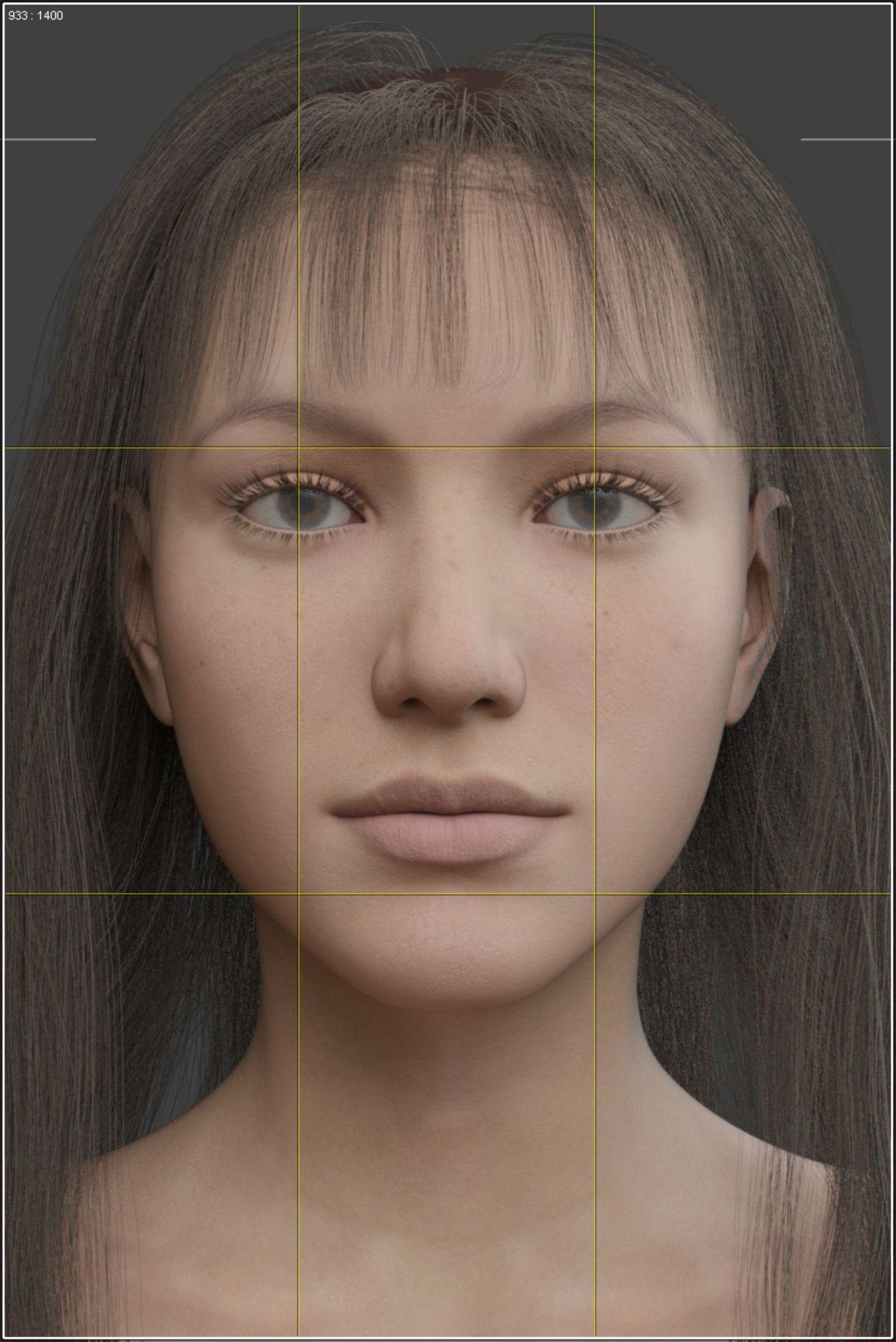

I think this falls under technical help for content, but please let me know if there is a better place for this discussion. I recently bought a set of hair from Daz (https://www.daz3d.com/dforce-fringe-benefits-hair-for-genesis-3-and-81-female) and for the life of me I can't get it to work properly. I should have guessed something was off when the title said "Genesis 3 and 8.1 Female" (though the site lists Compatible Figures: Genesis 3 Female, Genesis 8 Female, Genesis 8.1 Female). The issue, however arises that the hair doesn't really fit properly or act how I would expect for any of those figures. For G8F and G8.1F the hair comes off as uncannily wispy and doesn't move floodly with the bodies as other dforce hair does, for G3F the hair doesn't move with the figure at all unless manuall moved. When I tried to auto-fit the G3F hair to G8F to see if somehow that would magically do anything, it just set without asking to adjust to the figure as G3F hair typically does.

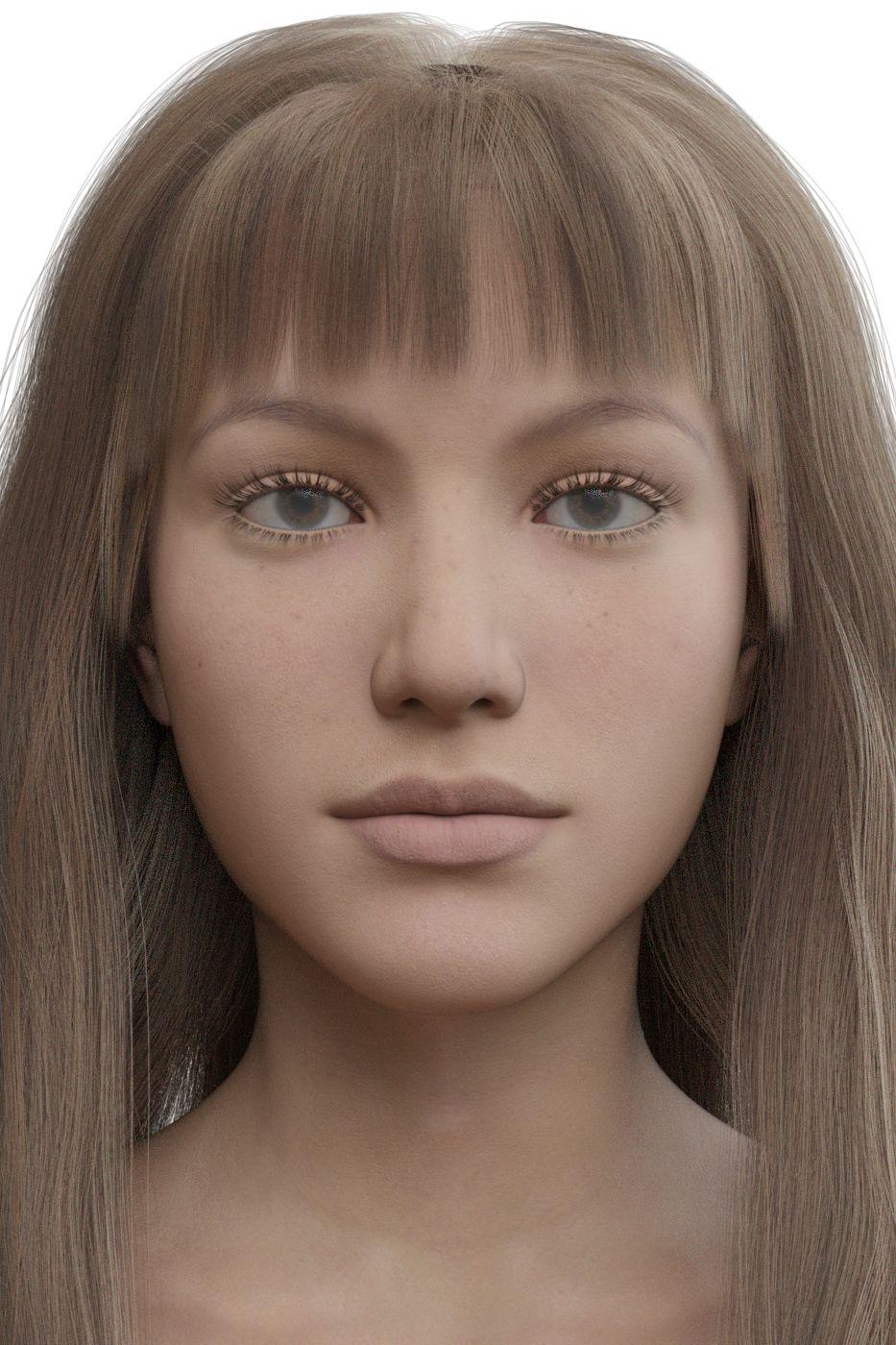

I've attached an image of the hair on the default G8F figure and the promo of the hair--the results are relatively the same for G8.1F. There are certainly some dials to manipulate but none led to the fringe being any fuller

    For strand based hair you usually have to make a real IRAY render to see all the hair. It looks like you switched the viewport to IRAY mode. This does not generate all the hair. There are specific settings which can change this however:
    • In the Scene tab select the Fringe Benefits Cap ► dforce Fringe Benefits Hair
    • In the Parameters tab navigate to General ► Simulation ► Hair ► Pre REnder (PR) and switch on Preview PR Hairs
    Full IRAY render
    Viewport screenshot with default settings

  • crosswindcrosswind Posts: 10,358
    For correctly previewing an strand-based hair node in Viewport, you have to turn on Preview PR Hairs and set the value of Viewport Line Tessellation Sides >=2. But be noted, in this way, it'll consume much more system resources.
