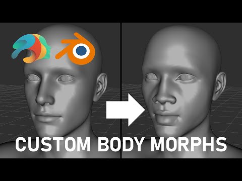

    First, thanks Richard for answering. Second, yes i used the same settings both times. It worked fine with Genesis 8 default body but scaled down and deformed wrongly on purchased character (teen model, 1.55cm or 5' height).
    I folowed the explanation on here ().
