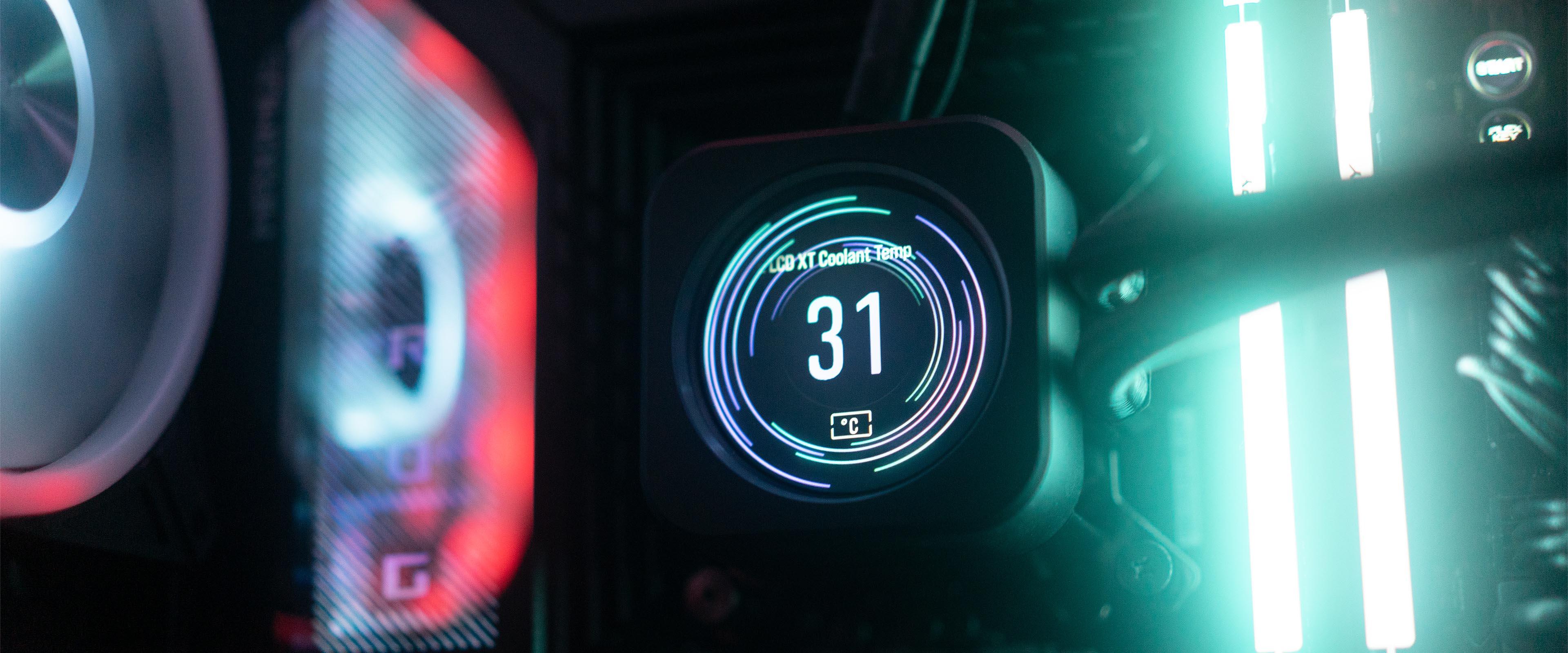

  • linvanchenelinvanchene Posts: 1,386
    edited June 2024
    • Processor: Intel Core i9-13900K - max 5.80GHz - 24C
    • GPU: ASUS ROG Strix GeForce RTX 4090 OC - 24GB
    • RAM: 2x 32GB - Kingston Fury Beast RGB - LED
    • Mainboard: ASUS ROG Maximus Z790 Hero
    • Case: Corsair 7000D Airflow
    • Cooling: Corsair iCUE H170i Elite XT / Corsair iCUE QL
    • Powersupply: Seasonic Vertex GX 1200W
    • Storage: Kingston KC3000 PCIe 4.0 NVMe M.2 SSD 4TB
    This build was put together in March 2023 - no crashes, no issues so far.
    You can replace some parts with more current equipment.
    The most crucial parts are power supply and cooling - do not make any compromises there...
    3840 x 1600 - 583K
