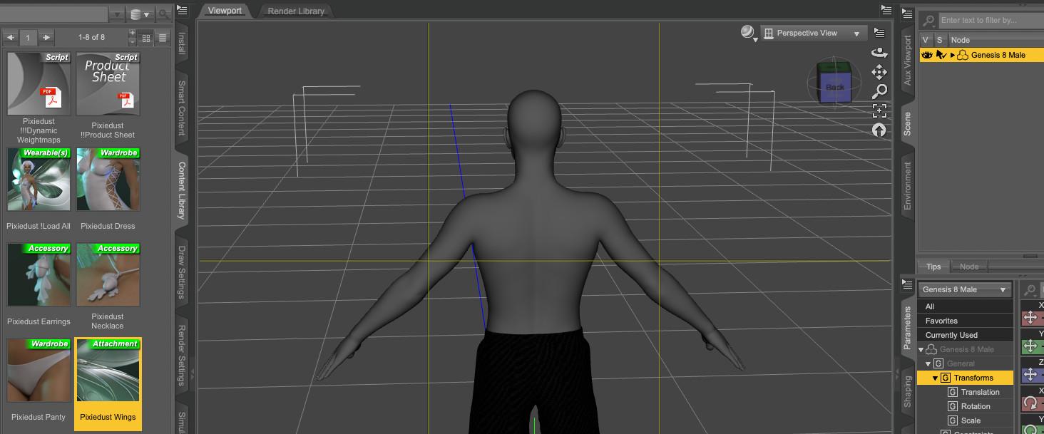

    1. Load G8M
    2. Select G8M
    3. Load the wing:

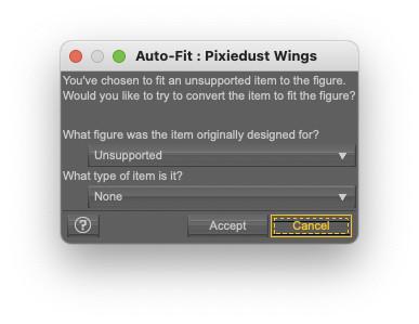

    4. Cancel the autofit process:
    5. Select the Chest Upper bone, the easiest way is to click on G8M's back in the viewport, between the wings:

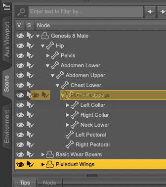

    6. On the scene tab, Chest Upper should now be visible so you can now drag the wings and drop them on Chest Upper:

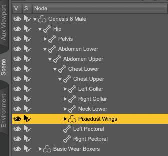

    In the end, your scene tab should look like this:

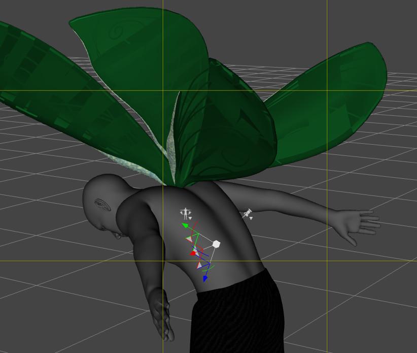

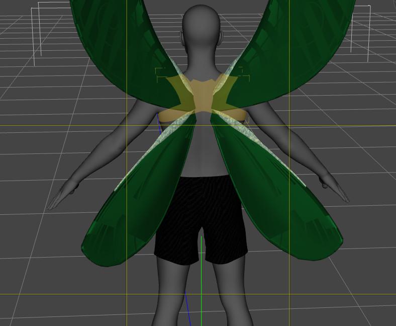

    And the wings should follow your character:
