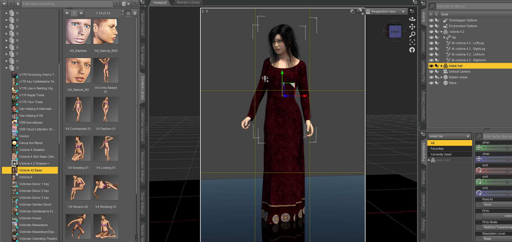

I seem to have 10 poses but the pack should have anther 20 where are they? LOL also I now need to figure out why when i apply a pose the dress wont follow it I need to read up i think

I was getting the Daz to crash if i used single fram and animated seems to work fine.
Any ideas how i get the dress to not go through the floor? it is set to collide but to have her feet on the floor the dress is already going through the floor.
Thanks
Make sure your ground plane has enough divisions for the dress to actually collide with the ground when draped.
If it doesn't work with a simple drape, try with an animated drape: start with the figure high enough for the dress not to intersect with the floor in frame 0, then lower her on the floor in the last frame. Or maybe do the reverse and move the ground plane up.
Ah so i can use a timeline to animate like a i would with dforce was not sureif the animation in drap would be the same as the time line
Yes you use the timeline when making an animated drape.
