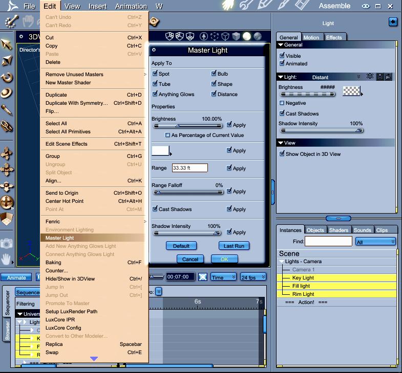

    Master Light - Select the lights > Edit > Master Light - See image for more
    785 x 730 - 442K

  • HeadwaxHeadwax Posts: 10,517
    that's too easy Dart, we want something that makes us work :)

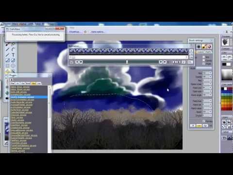

    I've picked up on a cool way to use Howler to add lightning to animations, which also works for other electrifying effects as well. Here's the tutorial I got the idea from:
    Here's my first try at the effect (animated backdrop is also included in Woodlands)

    I never use Master Light. I prefer to go into each house and control the lights separately - but that's me.
  • Thanks!
    Headwax: I have several of the DCG plugins, but had skipped that one for whatever reason.  Probably the shader tree was too complicated for me at the time; only recently have I started grasping it.
    Master light.  Who wudda thunk?  Not me, for sure.
    Off to play around.

    Howler Lightning!
