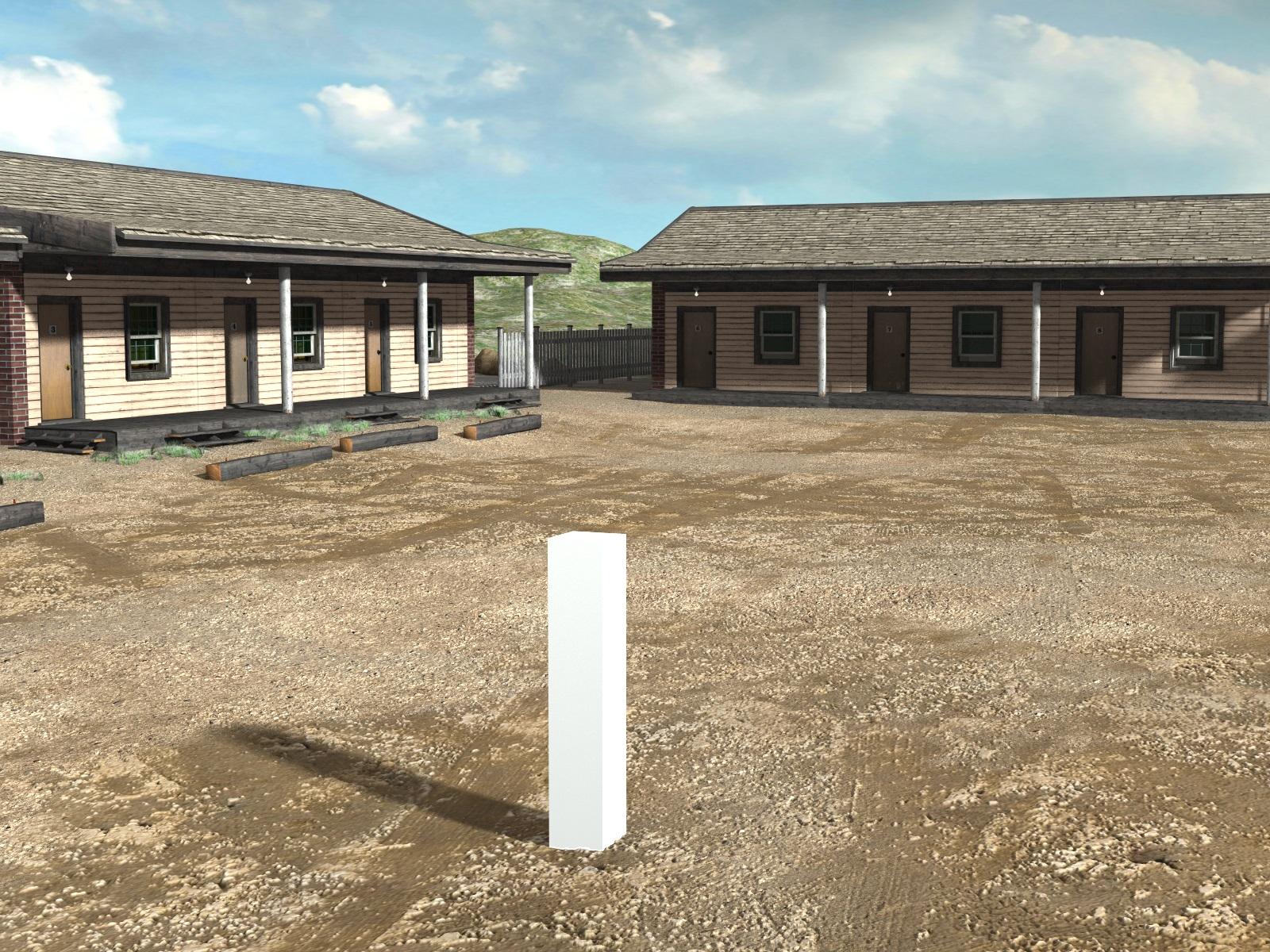

     I just loaded 50's Era Motel into DazStudio 4.21 .  The scene loads with a built in 3DL lightset,  it has Distant light named "SUN" it already has raytraced shadows set active.  The entire scene has a physical skydome.  In the 3DL version it is wysiwyg to the promo images on the store page.  The sun light does cast a shadow by default.
    Please note: there is also a POSER version of the scene.  DO NOT USE the poser version in DazStudio.  It is for Poser 6 or 8.
    Out of the box DazStudio 4.21 render, It does cast a shadow,  and an appropriate shadows for a sunny day with a bit of clouds.
