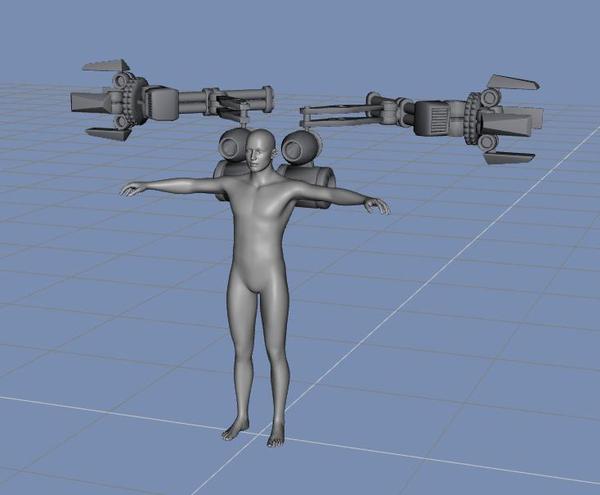

Sorry if i didn't explain things right. The object in D3DS is one solid object, however if i port the same object to, say for example, Blender the object is now fully editable and lets you do anything while in D3DS doesn't because it's one single object.
What i wanted to do is to take some parts of it and make use of it for something completely different. For example, take the legs and make them mechanical arms for the avatar in Second Life.
Just save out only the parts you want from blender. Save each part as a new .obj file. Then you can just load the part you want when you want it.
EDIT: DS is an ART program Blender is a modeling plus program. What you want to do is done in a modeler program.
FML, but thanks for telling me. I thought DS was a modeler as well. Oh well, i did what you said... took me a while but did it. Now i'm fitting this thing up.
However, back to the question of making an attachment that follows the movement of the Second Life's body, how to do so? :o
Update: this is how it's coming out.

If you take the new parts you want to keep and be very careful to name each 'group' something sensible [so you can find the right parts later] ... have it so if you do an import into D/S it's right away 'landing' where it should on the appropriate figure ... then if you clear the entire scene; use the Skeleton Setup tools, bring the object in there and rig it. Create the figure and export out a .cr2 file. [I have a couple of tuts over in my gallery at sharecg.com on rigging]
Then; new scene - load your figure; load the new .cr2 file.
Then; on the Scene tab [or by right-clicking on it] [somehow] parent the new .cr2 to the collar area [or whichever area works best] of the figure. So now providing you have the correct 'bone' selected when you adjust the dials on the Parameters Tab; it should move with the figure. This is not a clothing item. It is not going to move like clothing does. You will need to move the figure; then move the apparent 'extras' to have mechanical arm actions.
