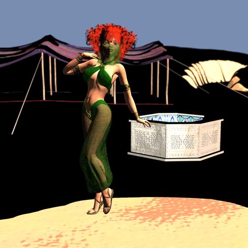

I am trying to render a character (see image below) but am at a loss why only one part of the floor is lit...and why the background is so dark?

EDITED TO SAY: I have also tried Uber Environment....which I have only just pruchased so don't know it well.

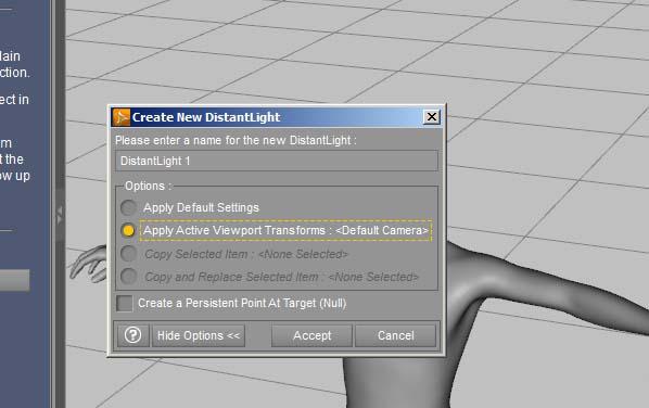

A good way to place a light is by ticking the box 'Apply Active Viewport Transforms', which is another way of saying 'Put the light where the cameara that I am looking through now is placed'. Use your Perspective view to go to where you want the light to shine from, and use the above method.

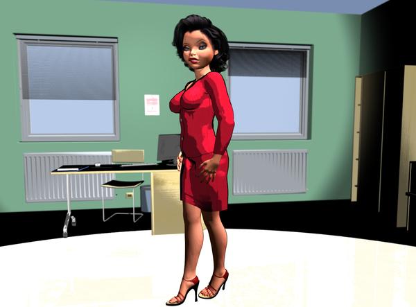

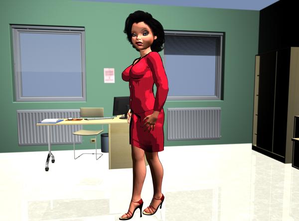

I thought this might be useful:
The first image is rendered on 3Delight default.
Second image is on 3Delight Cartoon.

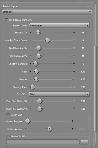

Last image is of the render settings for both.....
This is clearly an effect of the cartoon rendering - I hadn't noticed before but the desk top is also dark. I know I read somewhere that lights can seriously adversely affect toon rendering - although with the default lights (i.e. no added lights) it seems to be the same...I'm at a loss!
