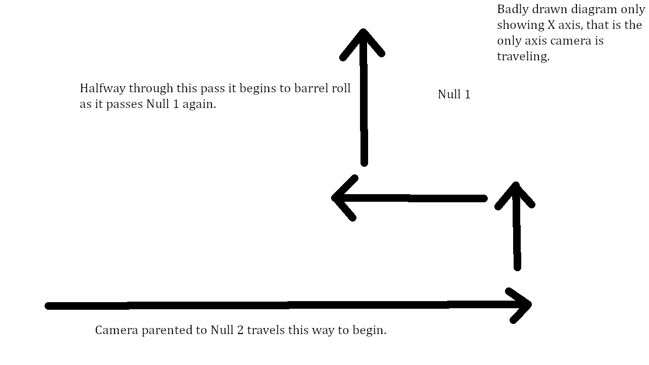

    Yes.  I spoke too soon when I made my second post.  It's still barrel rolling, it's just doing it on the second third pass now instead of the first.
    Locking the rotational axises does nothing to prevent it.
    LOL my terrible painting.
    Edit -> Actually when I played it back much slower it starts the barrel rolling on the second pass, not the third.  It's just not very noticable.  After the tilting begins it just gets worse and worse.
    Deleted the camera, made a new one.  Locked the rotational axises as advised, and the moment I pointed it at Null 1 the axises had already been modified...so yeah, locking isn't locking....
