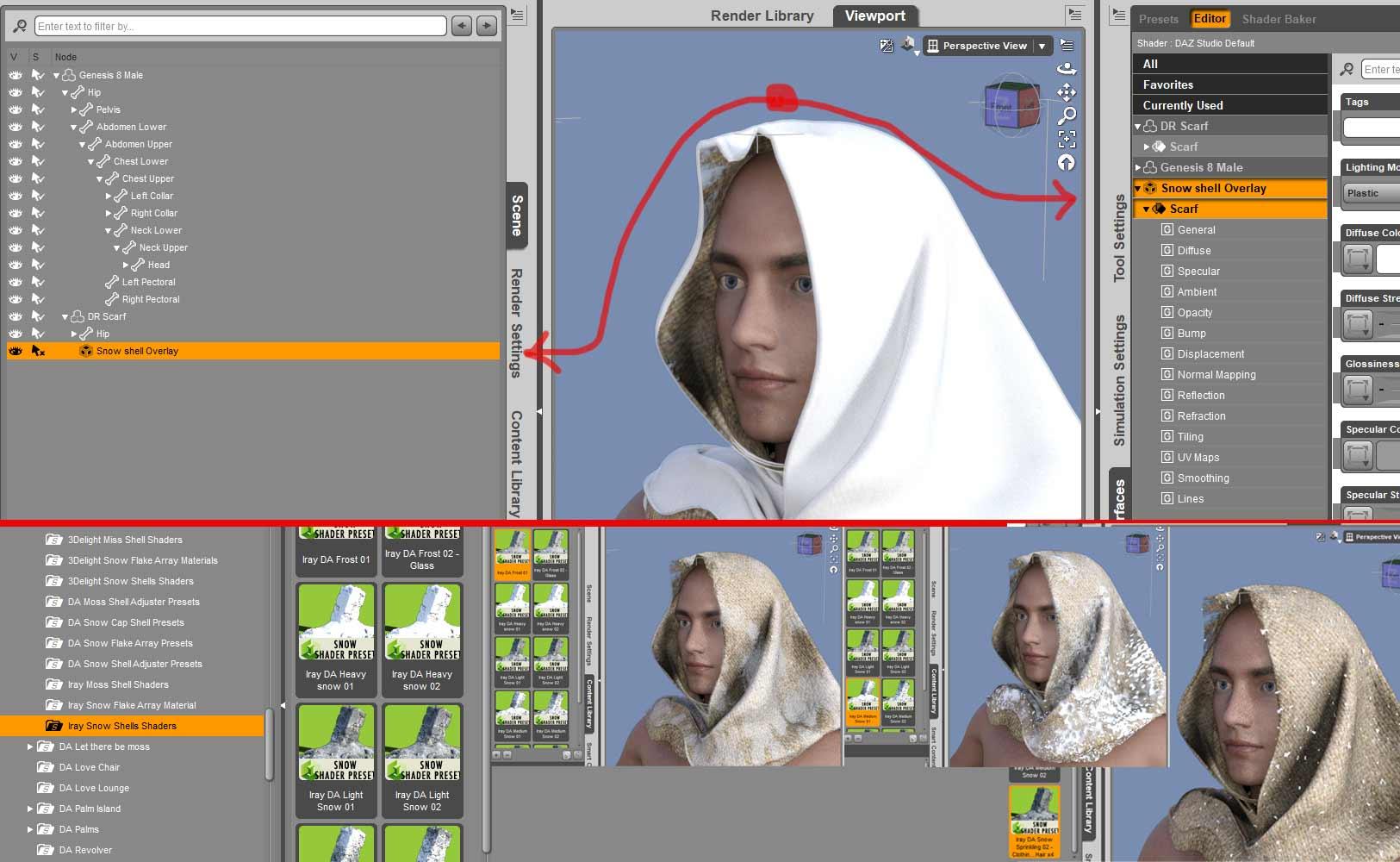

    Thank you so much @ DesignAnvil-Razor42 for all your help! I have, once again, learned so much about DS through this product - every day is such a learning opportunity and I do not regret having put in two days of work for this! More importantly, I am so happy to have chanced upon a PA who's so inspired and supportive of his product! I just looked through your store and have added a couple of dragons and horses to my wishlist :)
    Let It Snow is truly a very versatile and amazing product and to show its capabilities as well as my adoration of your post-sales support, here are before-and-after renders (with no post-work and the only difference being the LIS geolayers on the face, hands, beard and scarf) so that potential customers can see for themselves an example of what this product can do for their projects. This thread will hopefully also help them learn the ropes expeditiously. Thank you once again! Let It Snow! <3
