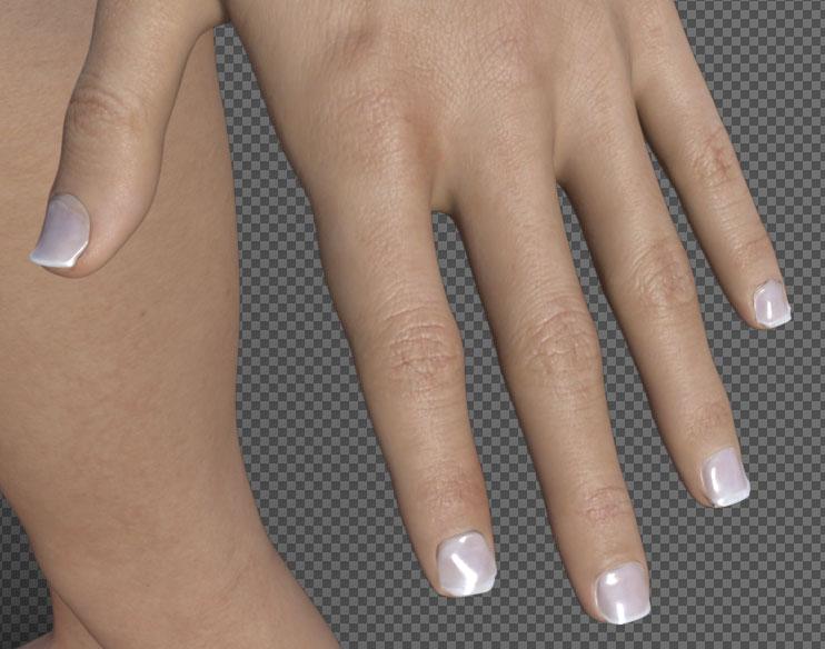

I have this with every single G8 female figure. (Haven't checked male.) There is nothing dialed in for nails.
767 x 629 - 111K
Post edited by lou_harper on

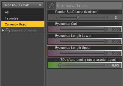

    In Parameters pane, with Show Hidden Properties checked, selecte Currently Used and see if there's any body morph(s) dialed...
  • lou_harperlou_harper Posts: 1,163
    I did that and scrolled through until my eyes crossed over and this is the only thing I found–I assume Toon Generations. Turning it to 0 made no difference, which is no surprise since the enable is at 0. Turning that up didn't help either.
    394 x 122 - 18K
  • crosswindcrosswind Posts: 10,358
    You selected Currently Used ? There's nothing dialed ?
    edited March 2024
    This is it:
    410 x 287 - 25K
    If so, try Zeroing figure's shape to see if there's any change.
    I did it with a G8 base figure loaded into the scene, no pose, nothing. I'm lost. But I realized I have too many G8 figures and I'm uninstalling a bunch.

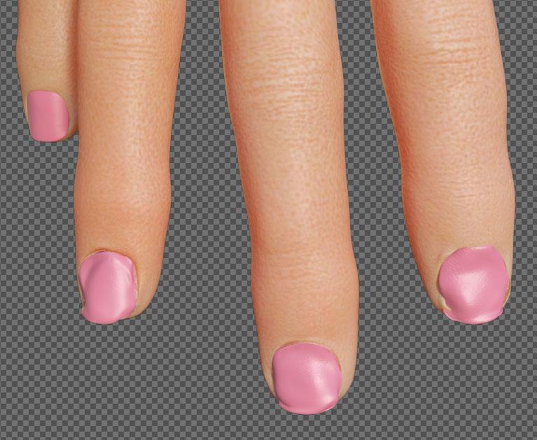

    edited March 2024
    Richard Haseltine said:
    A base figure isn't necessarily zeroed - if shapes ar saved with non-zero default values they will be applied but, because they are at their defaults, they will not show in Currently Used (I wish therte was a way to show non-zero values, which is what would help here)
    Genesis 8 Basic Female from G8 Starter essentials, and I ran Ultimate Zero on it. I don't know how much more zeroed I could get. Nails still messed up.
    742 x 584 - 81K
    Ultimate Zero seems to be about zeroing bone translations and rotations, what you need is "Zero the figure", which zeroes the morphs as well
    edited March 2024
    PerttiA said:
    Is it possible to write a script to find non-zero morph values? If it is, then it would be a great kindness if someone who knew their way round DS scripting could make and post one.
    Zeroing the figure makes those non-zero defaults also change their value to zero, and then they can be seen in "Currently used" with the value of 0 shown in white.
    To fix any ill-behaving (non-zero default value) morphs, do as follows;
    1. Open DS and load "Genesis 8 Basic Female" (to an empty scene)
    2. Right Click at Parameters Tab->Preferences->Choose "Show Hidden Properties" (part 3 zeroes only 'visible' dials)
    3. Right Click at Parameters Tab->Zero->Zero Figure (Zeroes the value of all the 'visible' dials)
    4. Right Click at Parameters Tab->Memorize->Memorize Figure (Sets the current value of all the dials as their default value)
    5. Edit->Save As->Support Asset->Save Modified Assets (Writes the changed default value to the morph files that were changed)
    When saving "Modified Assets" DS shows a dialog and asks for confirmation;
    "The following file(s) will be permanently modified:" - "Accept/Cancel" - Choose "Accept"
    Okay, that seems to have done it. Step 3 took 7 minutes. Step 5 should be File, not edit. ;)
    Thank you!!! I will save this for future reference.
