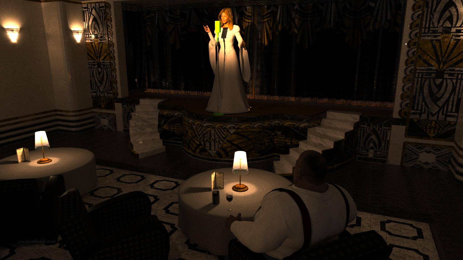

    If it is something like this all I did was make the decor bulbs emissive and added a spotlight shining on the singer.
    Click on image for full size.
    Got it. Can the lamps in a scene be controlled then? Sorry, I'm somewhat inexperienced in Daz, but what would it mean to "make emissive" the lamps? It's possible to control the colors of a spotlight too, right? I was thinking about putting a purple light on the DJ booth, while a red light would be responsible for softly illuminating the dance floor.
