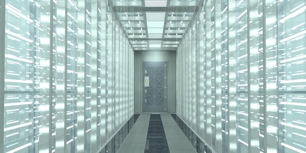

Is there anyway to add neon type lights to your daz scenes like in the image? is there anything you can get for this?
thx.
512 x 384 - 14K

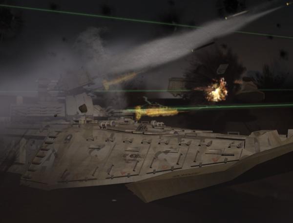

    It may take a bit of fiddling around to get the effect you desire but if you experiment with this you should be able to acheive a reasonable effect...I used it in a scene to simulate laser beams and it works fairly well.... the best results are acheived by experimenting with varying the opacity and ambient settings for the cylinders...
    As an extra option you can create a pointlight and set it so that it's inside the inner most cylinder and then scale it out to match the size and shape of that cylinder... but that adds an extra level of difficulty to the set-up as you'll need to experiment with the settings for the light to get the right effect from it...
    775 x 590 - 49K

    There are Omnifreaker Uberarea Lights with DS4P, and one is a tube. You can find them in My Library > Light Presets > Omnifreaker > UberAreaLight. Being shader lights, they can take a bit of time to render, especially with hair in the scene, but you could give them a try?

    That's true, but make sure you up the samples to reduce the noise in the final render! And Yes it certainly ups the render time. But hey you gotta sacrifice render time for good renders anyway ;-P
