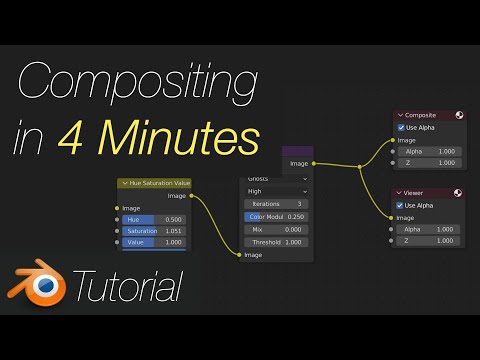

    Sorry I don't know after effects, but I'd be surprised if it doesn't handle HDR. Anyway the blender compositor is free and of course does support HDR and tone mapping.
    https://docs.blender.org/manual/en/4.0/compositing/types/color/adjust/tone_map.html
