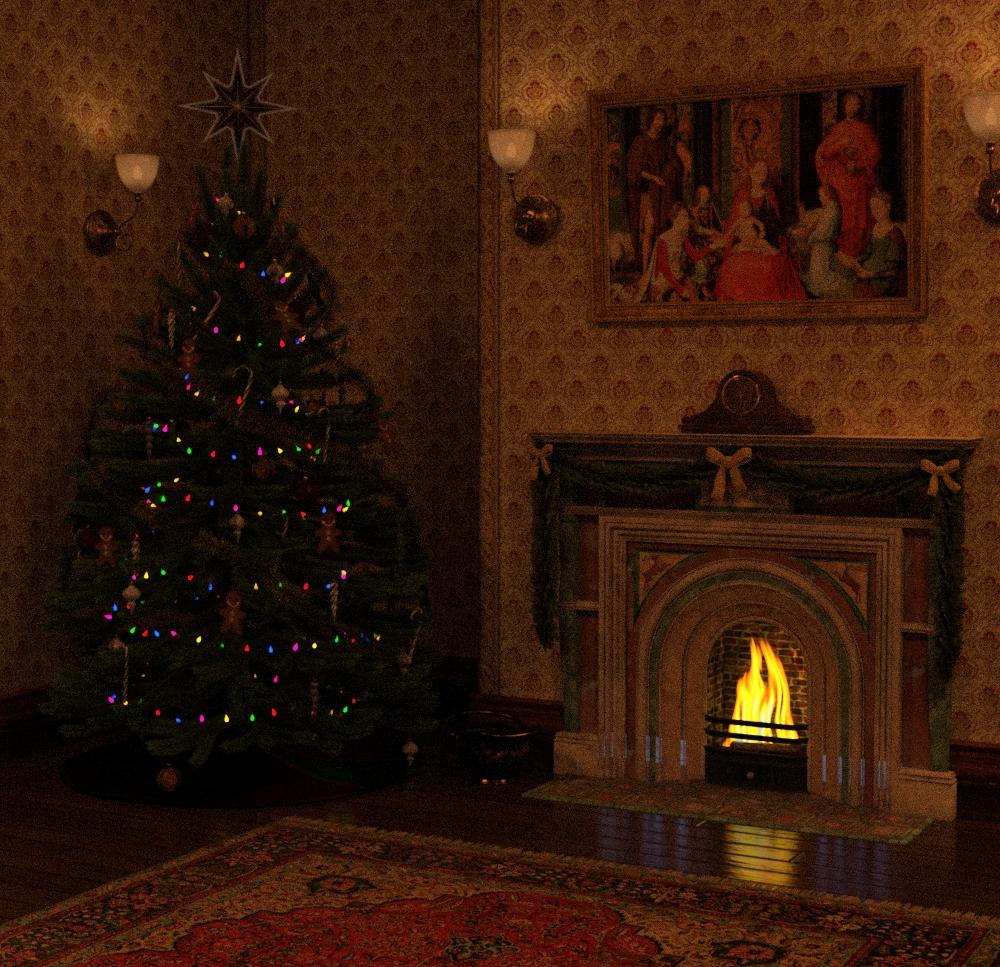

  • L'AdairL'Adair Posts: 9,479
    edited December 2015
    Scavenger said:
    Changing the temperature to 6500 seems to have helped. I'll have to learn what that is at some point. Thanks for that info!
    I don't know what you mean by groups.
    I was wrong on the freebie..it's the yulide treasures 2011 here.
    I have this tree, too. Thanks to this thread, I did some experimenting with the lights. I was unable to get satisfactory light colors just using the Emission Temperature (K) and had added the same color value from the Base Color to the Emission Color. I came back here and refreshed the thread and saw Szark's comment. So I tried setting the temperature to 0 and just applying the color to the Emission Color and that worked like a charm. (Thanks, Szark!)
    Images with a lot of emissive surfaces take a long time to render, especially in CPU Only mode. This image is at about 3.5% after 7+ hours. Very grainy because it's so dark. But I thought I'd share it here anyway...
    Yuletide Treasures 2011 and Yuletide Dreams by L'Adair
    1000 x 967 - 881K
