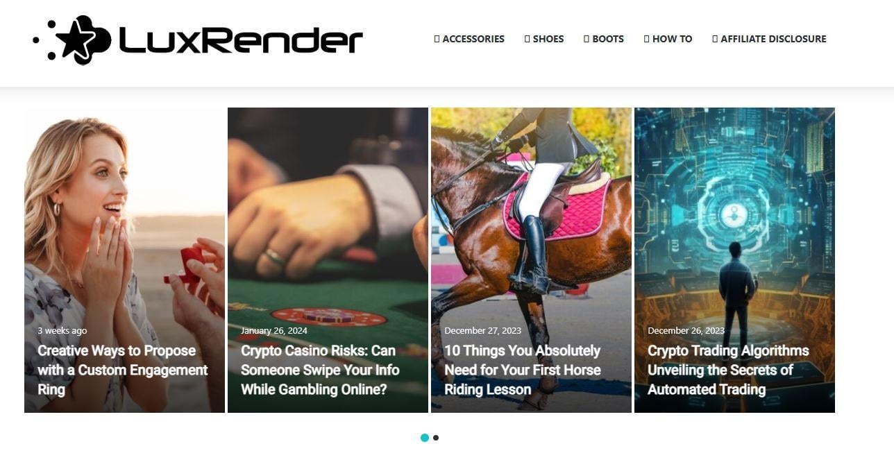

one question is luxrender.net gone?
I get from the PDF link this
Look on the date in the PDF files.
Lux you can find here > https://luxcorerender.org/
And maybe here (but not sure) > https://www.3d-board.de/downloads/category-file-list/279-carrara-deutsch-manual-shortcuts-languagepack/
ah, yep
just noticed
thanks
