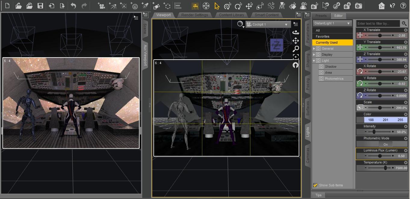

    I use a Distant Light as it is just the first one that comes to mind :)
    I used it as a back light on an interior scene of a space ship cockpit that had no back wall. There was light from the HDRI illuminating the interior but I wanted a bluish light from the back that would make it appear that there was more to the space ship than was in the scene. I also noticed that lowering the Intensity from 100% would soften the shadows thrown by it.
    Click on image for full size.
    1363 x 661 - 237K
