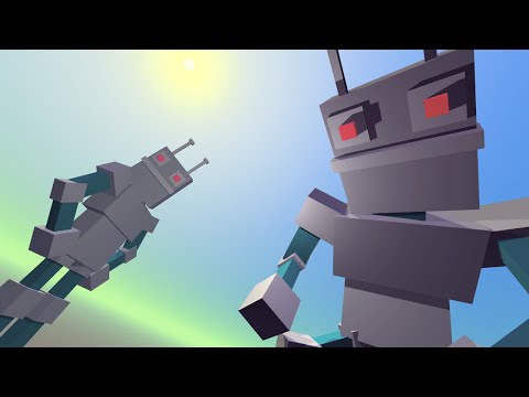

    By the way, I don't know if this would give you any ideas, but an artist named Michael Frank spent about half an year rendering this in 2012.
    He said it took him 700 hours. And this is 3 minutes long animation in 720p. However, I would guess that it's technically much more complicated than what you are doing, so I don't want to scare you from animation attempts. Just a curious example of how it can be though.

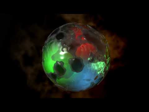

    After seeing such posts, I come to conclusion that "it depends" and sometimes 15 seconds animation CAN take douzens and douzens of hours, but usually it has to be something very fancy like this:
    I think if your project is not as ambitious in terms of using more tricky techniques, then perhaps something could be optimized. But in worst case, as I said, personally I'd propose you to render out in somewhat lower resolution, then use different software to upscale it (and you can use filters like dithering or vhs simulation or crt monitor imitation to make it look more cool and help battle the consequences of lowres original output).
