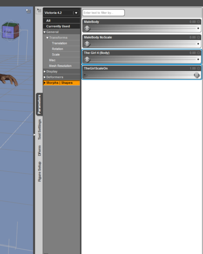

    I am using victoria 4.2 and i have checked the dials in parameters section.Nothing but only male face morph loads come up in morphing options.

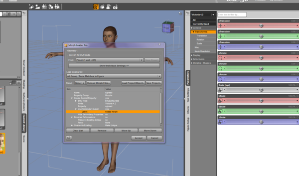

    the head did shrink to almost nothing when i imported it into daz... but my settings are in the images i uploaded. I have even changed the node to just head as well and still no changes
    1537 x 903 - 261K

  • holydragonholydragon Posts: 0
    image 2
    1060 x 857 - 170K

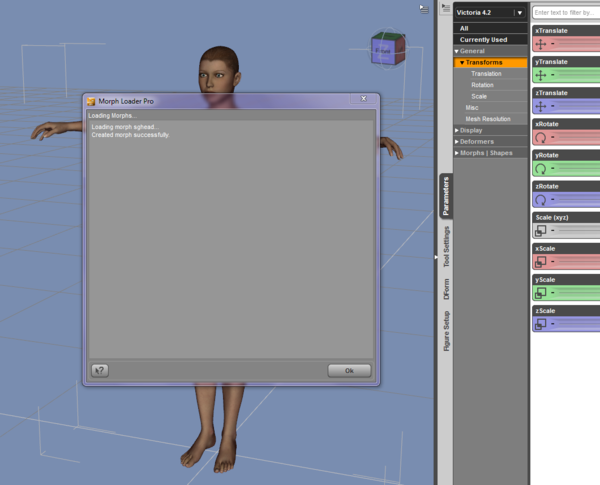

    no dials image
    718 x 900 - 69K
