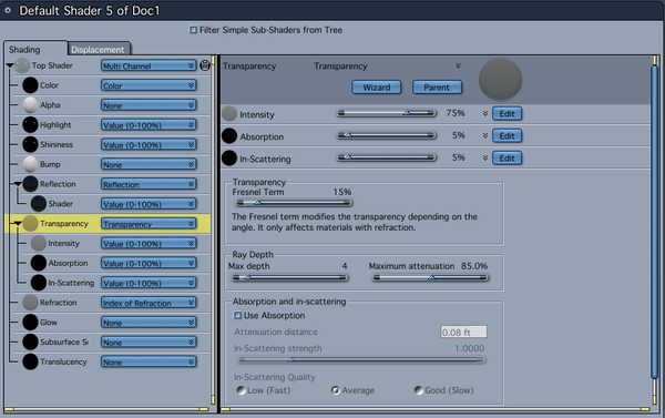

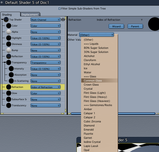

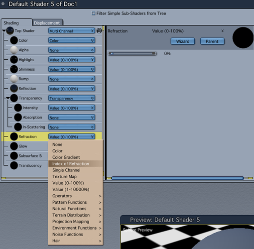

    There's also the shader to consider. Depending on what you want to do, you may need to set parameters for in-scattering, absorption, Fresnel, etc. which can be set under the Transparency channel in your shader. To set the Fresnel effect you'll also need to set up the Refraction channel. Look for Index of Refraction and try one of the glass presets. I'll try and post some screen shots to help you on the way.

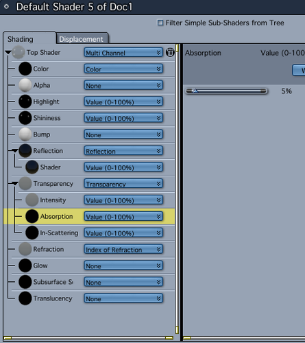

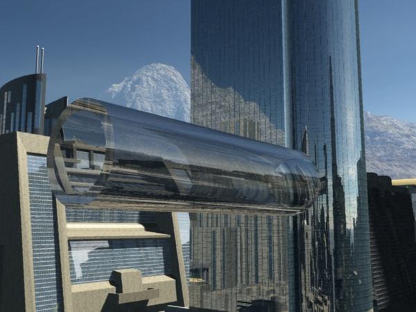

    Here's a couple examples. The first use the absorption and in-scattering functions in the transparency channel, a spherical image in the scene's background and the Skylight in the Render Room. I rendered from within the tube and from without.

    Here's the same two angles without using absorption.

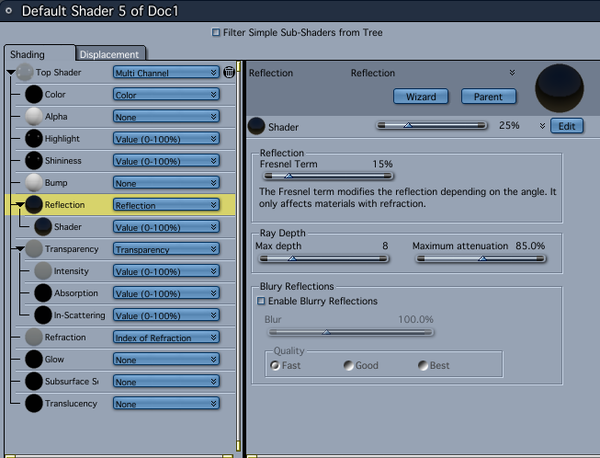

    Here's the shader settings.
    653 x 498 - 104K
    447 x 502 - 62K
    809 x 508 - 122K
    622 x 595 - 124K
    634 x 621 - 119K

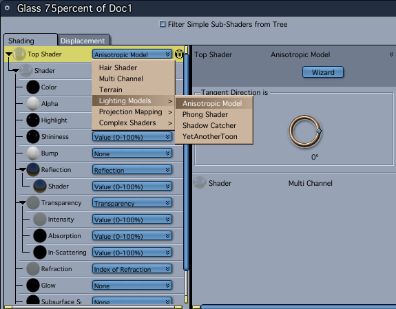

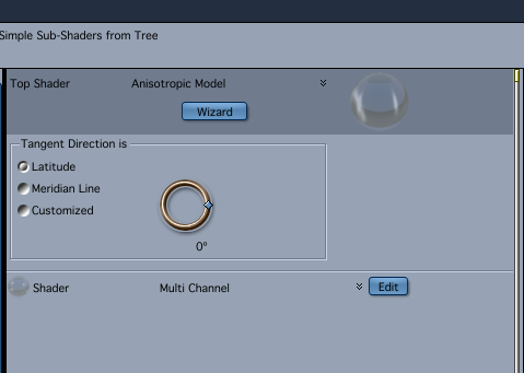

    Regarding the streaky reflections and/or refraction, I forgot about the different lighting models. You may want to set the shader up using an anistropic lighting model. Maybe in combination with the Fresnel settings you'll get what you want.
    479 x 341 - 30K
    575 x 449 - 93K
    640 x 480 - 194K
    640 x 480 - 167K
  • tami_7956c1f21dtami_7956c1f21d Posts: 0
    Thanks! I think this last screenshot is getting close to what I want. Playing around with this right now. One question - what is a spherical image in the scene's background?

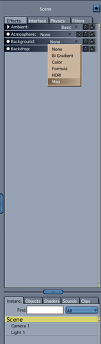

    A spherical image is one that can be wrapped around a sphere without distortion. Think of the Carrara universe as a giant invisible sphere. If you were to place an image in the Background in the Scene's settings, it would wrap around the universe. If it's a standard photograph it would appear distorted. A spherical render would appear normal. The cityscape in the samples I posted is a spherical render. The background has the advantage of being able to be reflected, used as a light source, etc. The disadvantage is that it cannot be seen until you do a spot render or render, and normal images are distorted as mentioned above. The best place to use a normal image is in the Scene's backdrop. The backdrop is not reflected and cannot be used as a light source.

    DAZ's site (and several other) was acting up on me last night and I couldn't upload a screen shot of how to set the background image.
