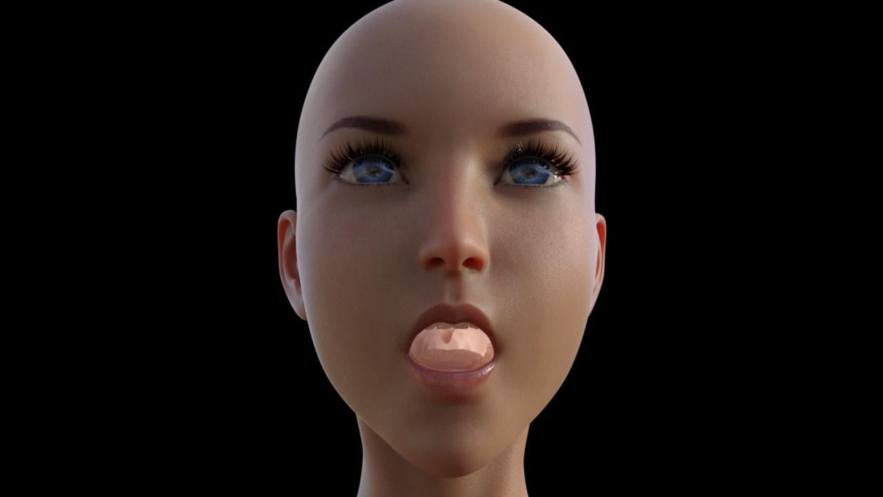

How do I stop Aiko 8's mouth from glowing?  I can't make her smile or her teeth glow from the amount of light coming out of her mouth.
I've seen several threads related to glowing mouths, but all were using the 3 Delight renderer.  I don't use 3Delight.. those threads suggest disabling SSS (how? I get no "off" option for SSS), or making sure the lights in your scene are casting shadows (lights set to Raytracing and glowing mouth still persists).  I'm not sure these fixes even apply when using Iray anyway.
So what's up with the glowing mouth, and how do I put a stop to it?  The glow ends up moving to any model I create that I apply Aiko 8's skin to.

  • Select the mouth and teeth surfaces (window > Pane > Surfaces) and then dial the Translucency Weight Channel down to 0 to disable it.

    To me, some properties on Mouth surface are just wrongly set ... The vendor set Translucency Weight on Mouth surface but did not (or forgot to...) set Transmitted Color as well as SSS Amount, and certainly they did not check it either by "opening figure's Mouth"...
    Your surely can request refund,  or simply set proper SSS values on Mouth surface... as below.

    If you use the figures with any HDRI the glowing issue is much less visible, this is probably why the PAs didn't notice it. The issue is much more visible with scene lights only, especially with a strong backlight. But yes, setting translucency without volume is wrong in terms of pbr material, at least if you want to make a human skin.

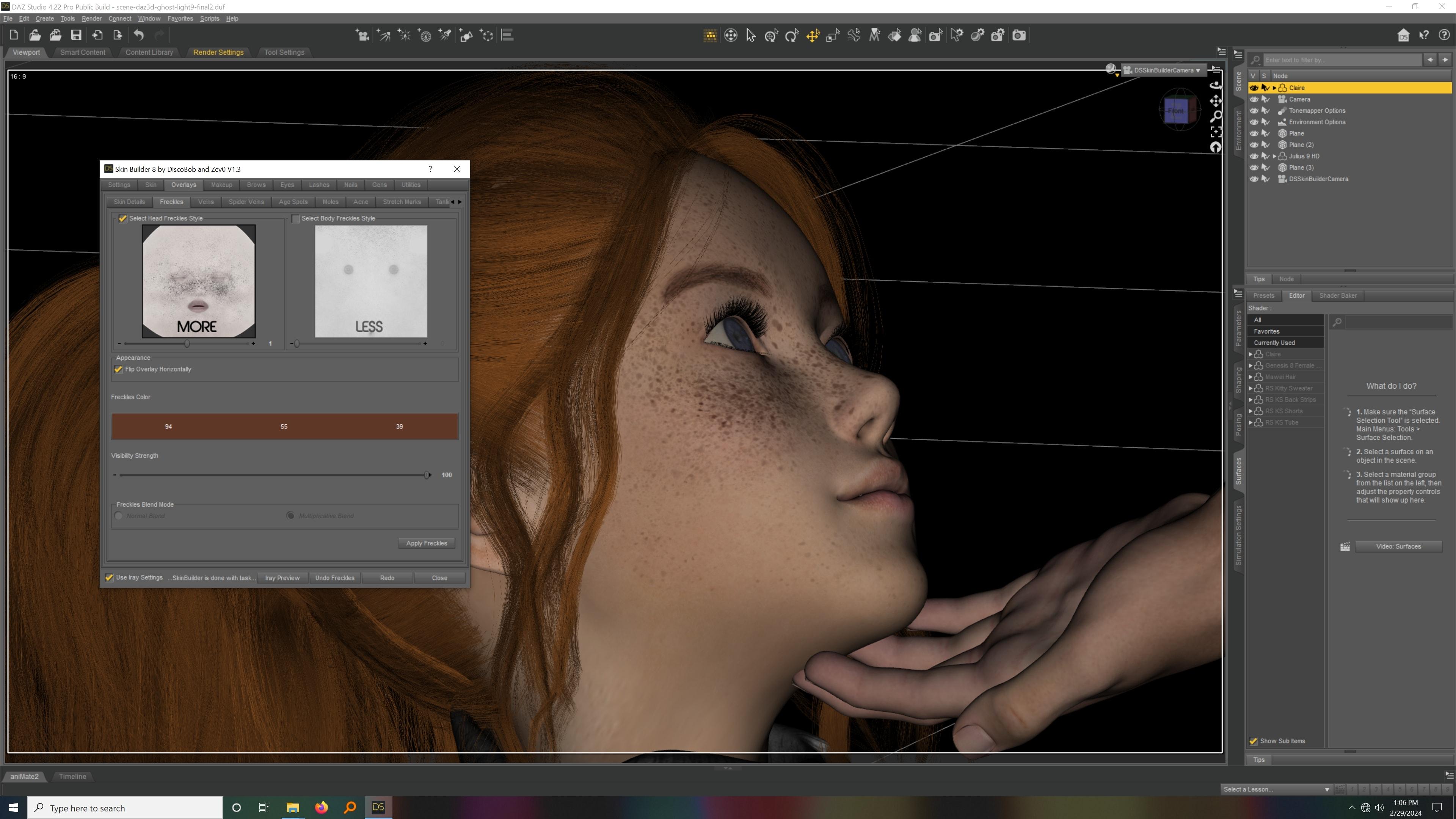

    Anyone have an idea about this one?  Materials that show up in Texture Shaded view but don't show up in Iray Preview or in a render.  This is also plaguing most of my Genesis 8 characters, and Skin Builder is great.  I've used it for a while now and its always worked.  In the Iray screenshot, there's also this really weird moisture effect/shiny effect that begins to gather around their mouths,  It doesn't look real bad there but if I were to render that it would come out looking like morning dew or something.  I can't help but feel like there's some deeper problem causing multiple issues, but my Daz logfile is silent because I've nuked any packages I couldn't fix myself straight out of it...and in general things seem to load ok, maybe a little on the slow side for my system specs (14th gen i7, 64gb ddr5 ram, 32gb vram), but that's probably because of lots of morphs.  A few weeks ago none of this stuff was happening, or maybe now that I've become more comfortable with Daz I'm just doing more with it than I was then....idk... either way it sorta sucks that I can't use materials like freckles?
    Freckles are applied...
    But this is what I end up with....
    3840 x 2160 - 754K
    3840 x 2160 - 539K
    Post edited by suffo85 on
  • FenixPhoenixFenixPhoenix Posts: 3,247
    edited February 2024
    Check the Translucency Map. If the extra detail is being applied only to the diffuse map (base color channel) and you have a character with high translucency (which is the case for most G8 characters), then you need also to apply that LIE Texture to the map set in translucency color for the texture to also show in render.
