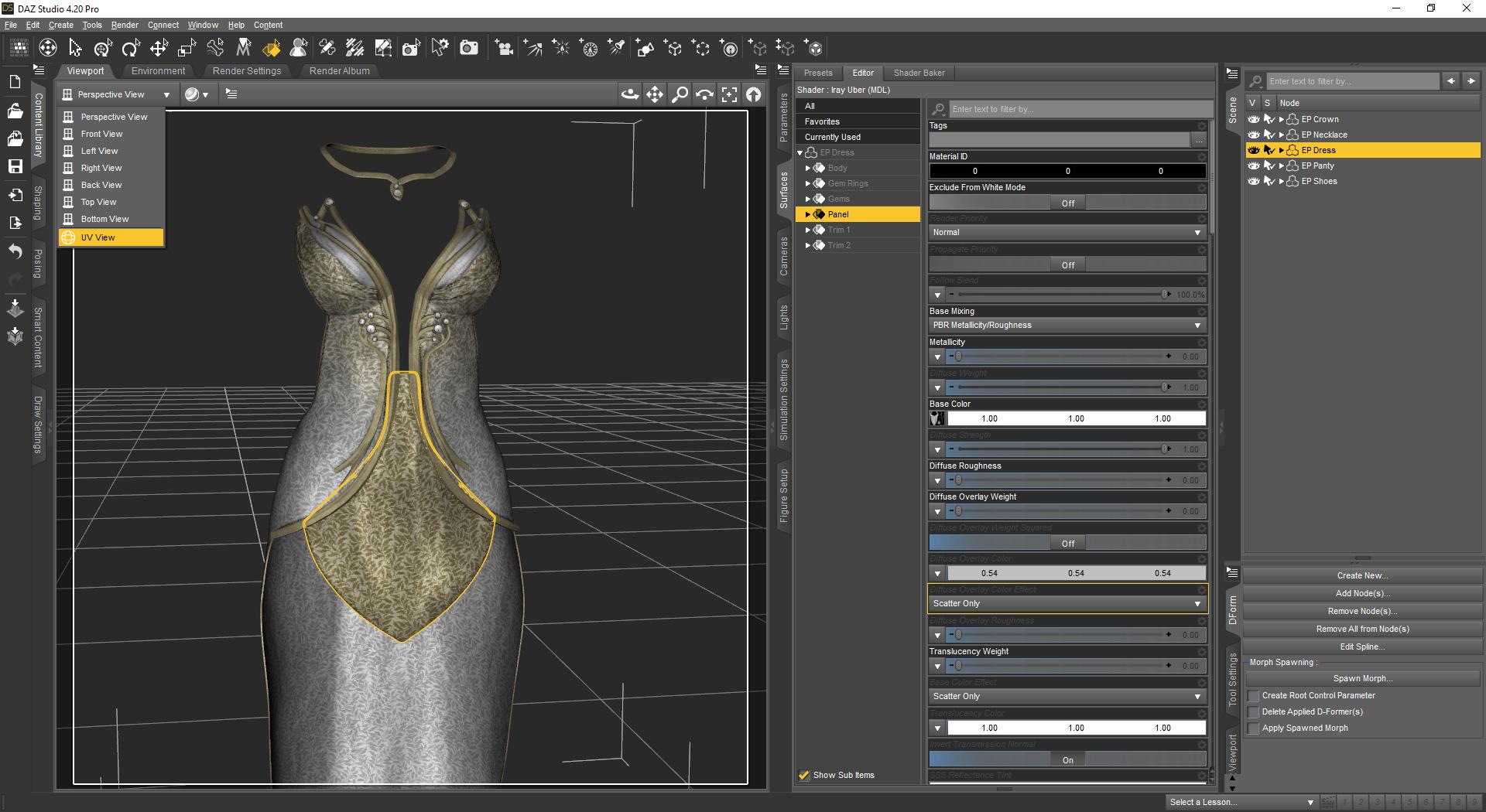

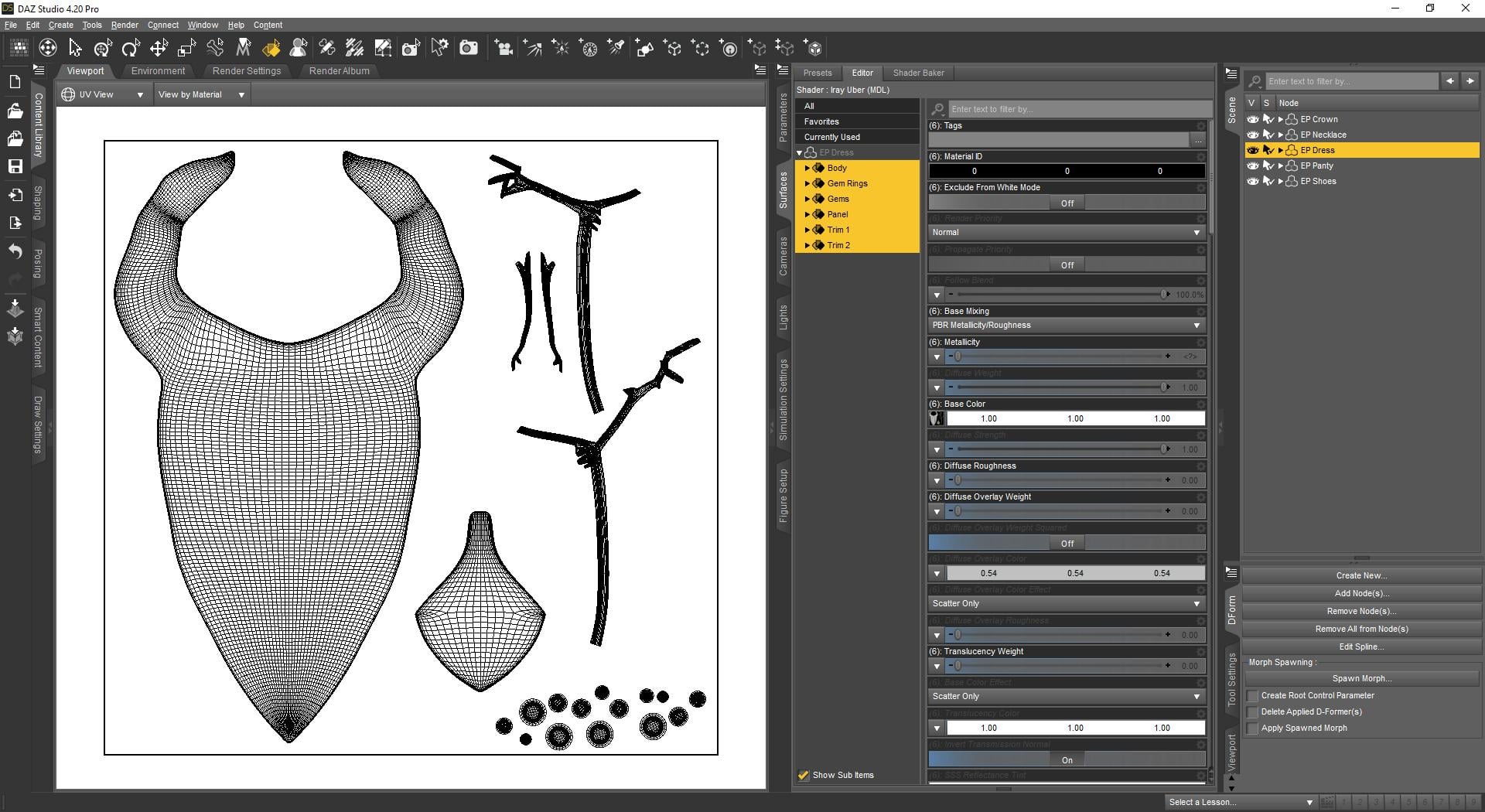

  • EthinEthin Posts: 1,343
    edited February 2024
    In the "View" drop down menu select "UV View"
    Select the item in the "Scene" tab then select the surfaces you want the UV's for in the "Surfaces" tab.
    Take a screenshot and paste it in your image editing app. You'll have to crop to and scale the UV portion.
    It's not ideal but it better than nothing.

  • Ethin ... I don't not know you could do that, good to know and thanks.
