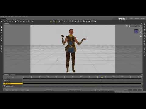

    Greetings Sir. Hope you are doing well, I am a fellow student from your wonderful channel and right now, I seek your guidance.
    Please refer the first video titled "Create a playable Daz Character in Unreal Engine 5.1 (Live Retargeting)"
    At 6:39, although my blueprint compiles but while replacing the BP Third Person Character + Anim Class for new Daz Mesh (ABP_Pearl renamed instead of Mira) what I am seeing is Daz mesh leaning absolutely wayward! I have attached screenshots and need your assistance, what can be done, how can I rectify such error?
