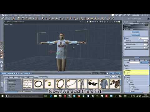

  • I changed the end date to the end of July.
    I've also added a new functionality. It's now possible to add a morph to a Gen4 cloth, even if there is no channel available.
    It works only for Gen3-Gen4, will crash for Genesis (but there is no channel issue for Genesis).
    You can dowload it here:
    https://drive.google.com/file/d/0Bztu9Tp7eavmdFN4dnhIUHItc1E/view?usp=sharing
    See the demo:

  • AntaraAntara Posts: 444
    @Philemo Thank you!!! I can see the options now. And thank you for the video tutorial! Very helpful!
    I haven't been able to get the results as good as some of the examples here, though. I am going to play with it some more and if it doesn't get solved, I will come back with some more specific questions.
