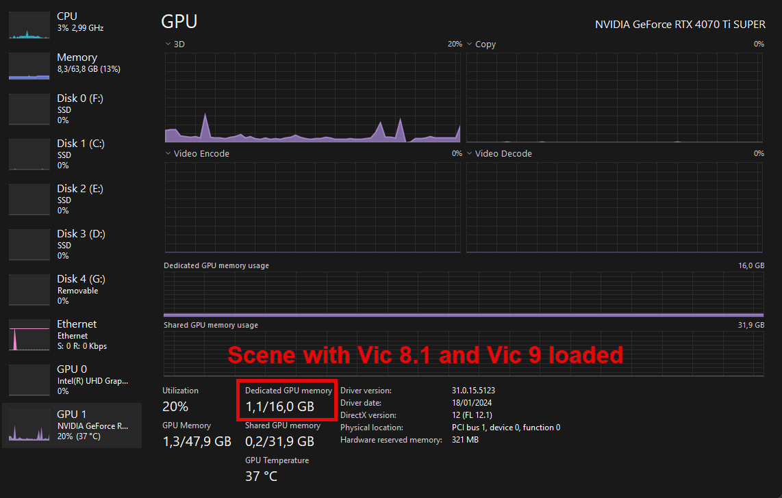

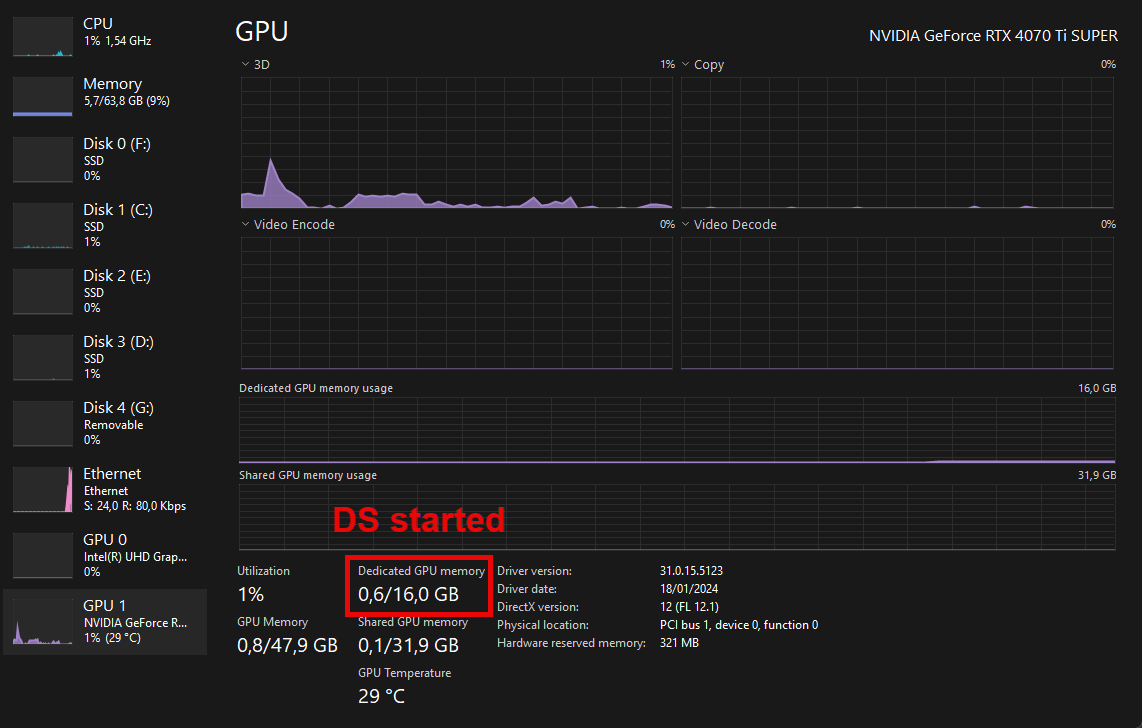

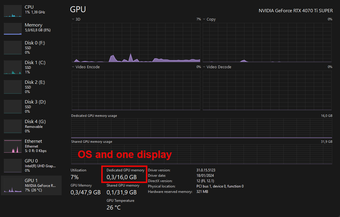

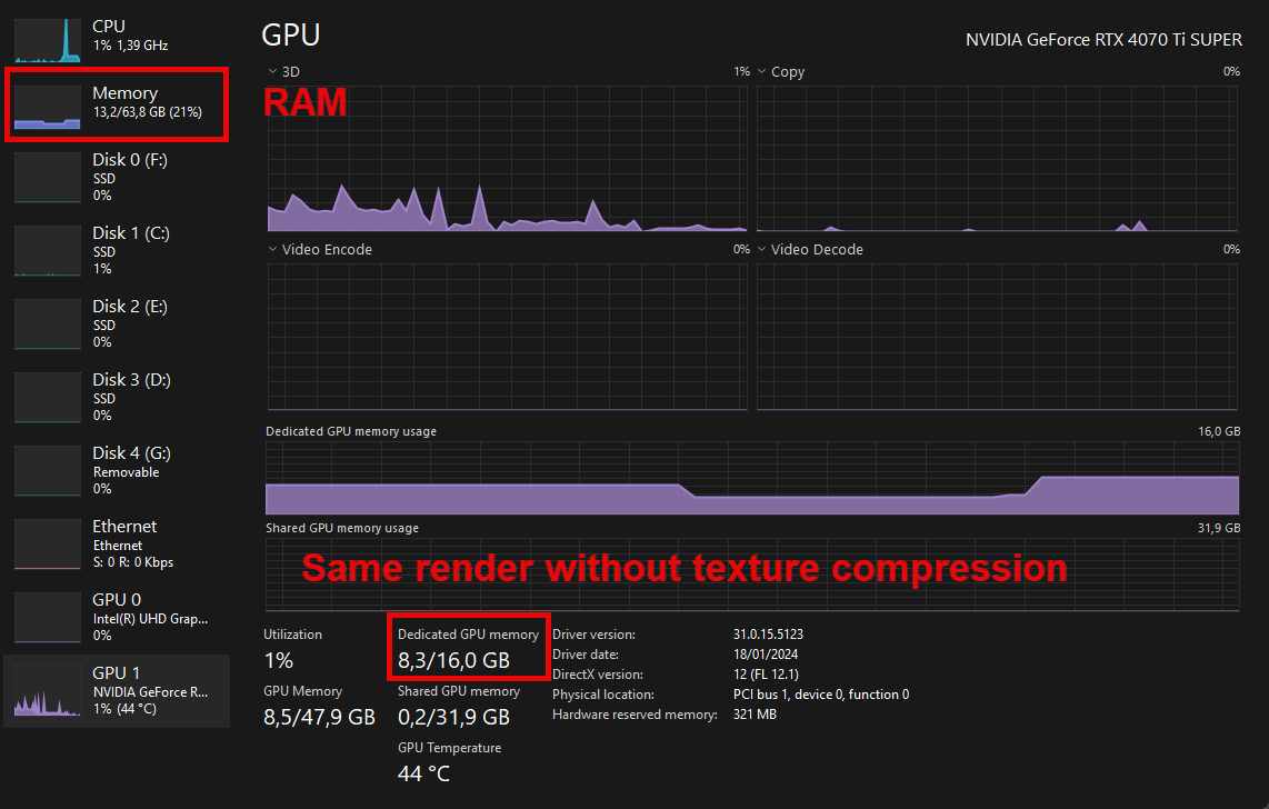

    A quick test on Windows 11 (OS consumes about 300 MB vram - more if a second display would be attached, less if no display has to be driven by the card).
    Figures were default without hair. Render was with default hdri background.
    With clothing, hair, props etc. it already might get crowded in 12GB of vram (at least with texture compression = off).
    Regarding vram consumption when DS is started. When you start a render, DS consumes vram and is not releasing all of it after stopping the render. My example below: DS plus scene loaded = 1.1GB on first start. If I stop the render, DS sticks to around 8GB (textures, shaders etc. are cached on the GPU) instead of going back to 1.1GB. But that is not an issue because the cached data gets overwritten if required.
    Post edited by cgidesign on

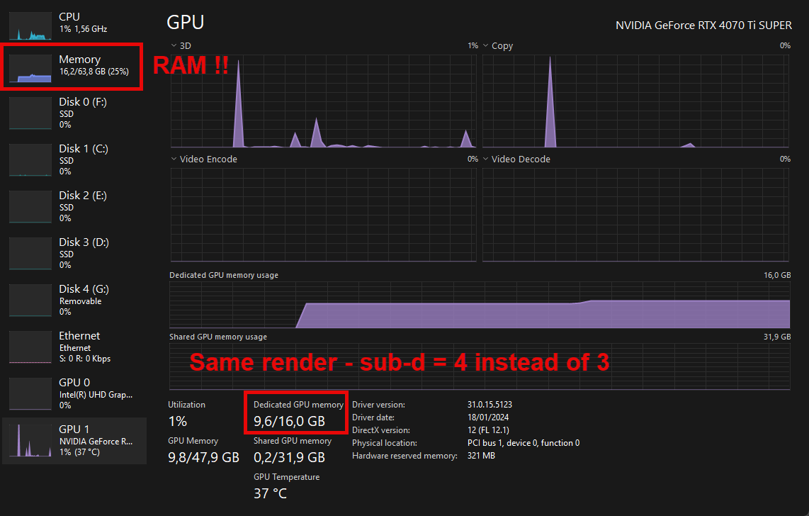

    Update to my previous post. I forgot to mention that render subdevision of the figures was set to 3.
    Here is the result with 4. In this case the 16GB ram would not work anymore (but sub-d 4 is not really required in most cases).
    So, 12 GB vram and 16 GB ram can work - as long as your scenes don't get to complex and you stick to texture compression and sub-d 3 - but you won't have much headrom.
    Maybe a used 16 GB GPU and more ram? But I know, even a used card plus ram might be over 500$
    On the other hand, while my PC was broken, I worked with a notebook (16 GB ram and a 8GB RTX 2070) and stll was able to have fun with DS.

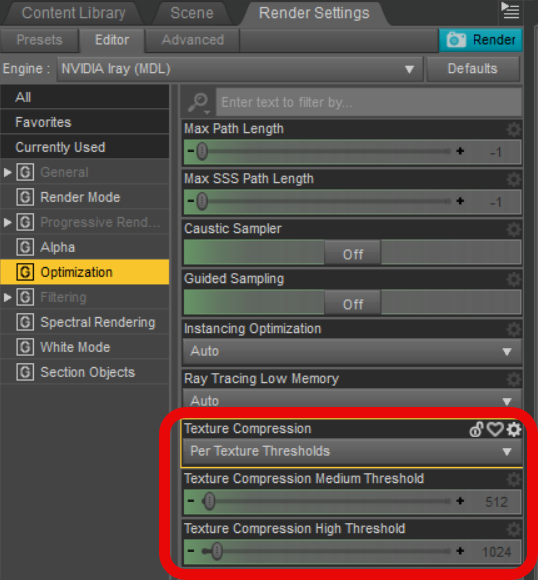

    Also what exactly do you mean when you say "with Texture Compression"? Turning the Detail levels from High to Normal? Or something else?
  • cgidesigncgidesign Posts: 442
    edited February 2024
    It is a feature of Iray. It is taking the textures and compressing them on the fly. As you can see in my example it can save some vram - but it can come at a cost. In some cases you can get compression artifacts in your images.
    You find it in the render settings:
    Here are the settings in DS 4.22.x
    The below linked thread shows an example of compression artifacts:
    https://www.daz3d.com/forums/discussion/544816/what-s-causing-these-shader-artifacts
    And this thread explains the settings in the older DS versions (the UI has changed a bit in 4.22):
    https://www.daz3d.com/forums/discussion/comment/7266596/#Comment_7266596
