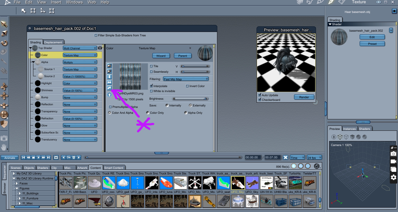

  • Bunyip02Bunyip02 Posts: 9,333
    edited February 2024
    Shader setup
    1359 x 723 - 431K
    Post edited by Bunyip02 on
    As for creating a model of different hair-styles in Carrara maybe Stezza might add some knowledge.

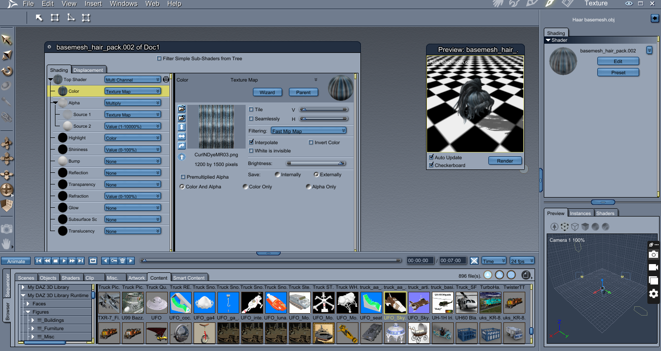

    Khoe said:
    it works very well with the textures, thanks.
    I have no idea why mine aren't working properly.
    Good that you know all this. :)
    Hello Khoe, glad it's working for you.
    Suggestion for the red dress hair, rotate the shader 90 degrees and see if it looks better.
    1359 x 723 - 469K
  • KhoeKhoe Posts: 345
    Bunyip02 said:
