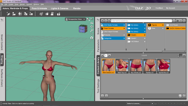

ok I am an airbrusher and use daz as a model for my art work to position figures in just the right pose......I have 4.5 and have used daz since 2010 the old stuff worked good and so the new should work at least that well. Not necessarily the case as I am finding out.

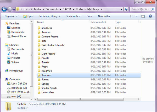

I believe since i had Daz set up on my old harddrive in XP 32 that it would be safe and secure there and and new files i had i would send to the new Drive (H) in my case. I downloaded 4.5 installed to H things like vicky4 base, 4.2, amandas hair ,desire hair, v4power loader,jeanz,,crocodile,genesis,Catllin,VH Carina for Victoria 4 and Genesis, 25 downloads in all now after carefully installing only about 1/2 of the stuff works and it is scattered between 3 drives.(I was careful to install each of the 25 to a single place H:/users/ buster/docs/daz/my studio/library yet when i open the program i see content from everywhere and most when selected will not move from content to the figure chosen and if it does it it will not stay attached and yes i downloaded auto fit and when you try and put in the serial number it does nothing either. Please some one out there help me this was supposed to make painting simple and fast and has been anything but so I am quite bewildered.
First question. Did you set that folder up as both a Daz Studio Formats path and A Poser Formats path in your preference's in DS4.5Pro?
I let it auto run and there is poser formats in the main H directory (runtime)
I see the item loaded but is not FIT to the character. For items to Auto fit you must have the character selected in the scene when you load the item. A quick fix would be select the Item in the Scene Tab and then open the Parameters Tab at the bottom find FIT TO and set it to your character. I think that is all that is happening.

procedure select genesis figure
content library select bottom
scene click on bottom
parameters misc fit to select genesis same result no fit
You are using the Standard version of DS4 because you have not entered the serial for the Pro version from your Account. Autofit only works with the Pro version. If you bought DS4 Pro through the store via your shopping cart, you should have a serial number for it in your My Account area. Next time you load DS4, go to Help > Register, and enter the Pro serail number, Exit DS4 and restart, then you will have the Pro version and Autofit will work, no need to enter any further serails.
