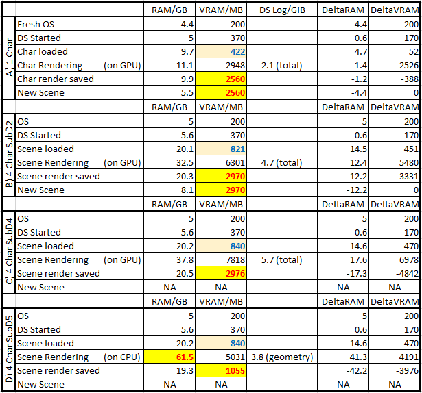

    Some time ago, I googled alot to find information about this often mentioned relation between ram and vram but didn't find any technical article confirming this. Only in forums etc. there is often written one should have three times the ram (e.g. 24GB vram = 72GB ram). It seems to me this x3 is a myth. E.g. I was using the 3090 with 32GB of ram and there was no issue with this. Be it Blender, Cubase, DAZ, Games, Benchmarks, etc. everthing worked within expected speed and stability. On the other hand, once I got more vram, I was able to make bigger scenes and ocasionally I was reaching the 32GB ram limit (scene loaded in DAZ, some HDRs open in Affinity, a normal map open in another tool and so on). Because of that I now have 64GB ram but those are not needed to drive the vram.
    Googling doesn't help much as it's about rendering Iray in DS and pushing the GPU to it's limits, of course one can have an RTX 3090 even with 16GB's of RAM, but why bother getting a GPU with 24GB's of VRAM when one can't use it all due to lack of RAM?
    Below is a test I made some time ago to see how much RAM and VRAM was used while rendering in IRAY (in W7) with the default Iray compression settings
    Case a) just one lightweight G8 figure with lightweight clothing and hair
    Case b) four similar G8 characters with architecture
    Case c and d) started increasing SubD on the characters to see at which point the rendering would drop to CPU
    "RAM/GB" and "VRAM/MB" taken from GPU-Z, "DS Log/GiB" taken from DS Log, no other programs were running but DS and GPU-Z
    The "DS Log/GiB" is the sum of Geometry usage, Texture usage and Working Space - After Geometry and Textures, there should still be at least a Gigabyte of VRAM available for the Working space => In my case, Geometry + Textures should not exceed 4.7GiB
    Note; Case c) was already using 38GB's of RAM, even though the rendering was done on the GPU, Case d) when rendering on CPU the RAM usage went almost over my 64GB's
    Tests made using RTX 2070 Super (8GB), i7-5820K, 64GB's of RAM on W7 Ultimate and DS 4.15
