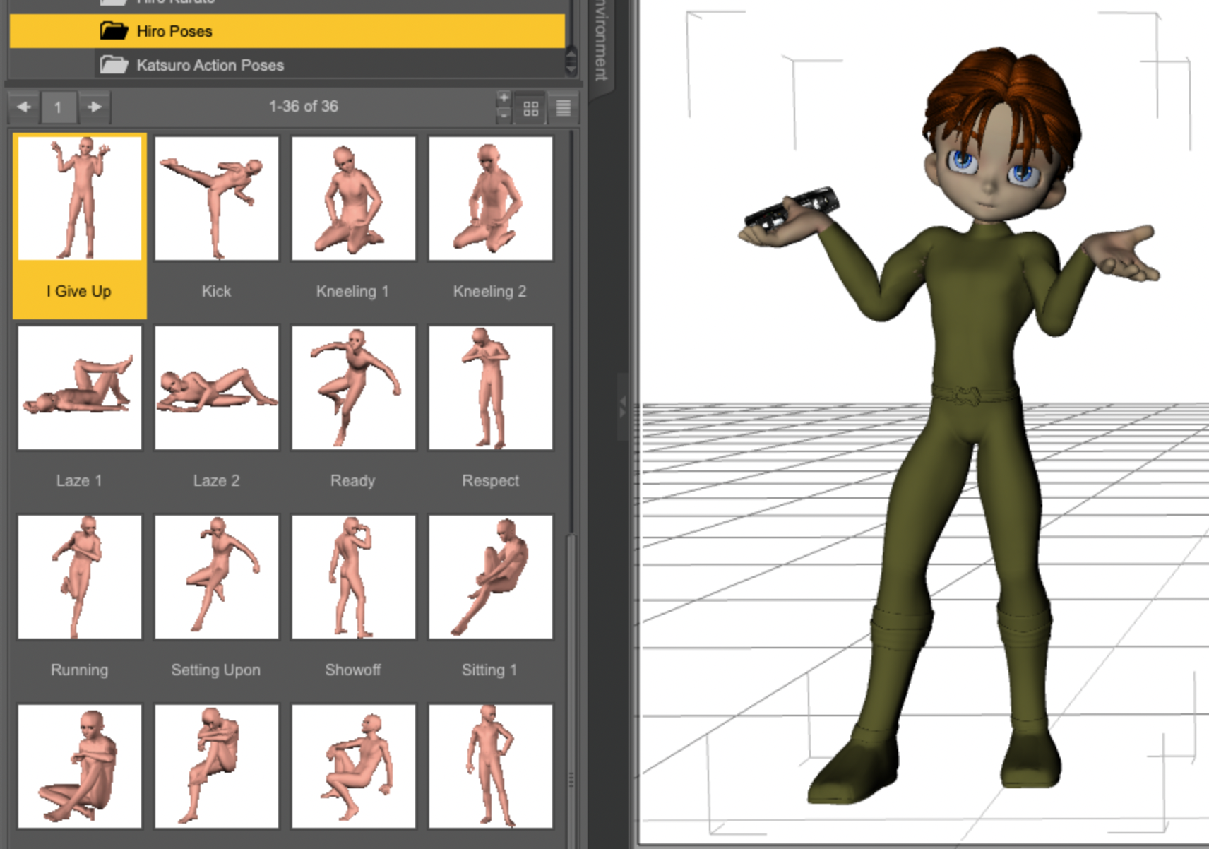

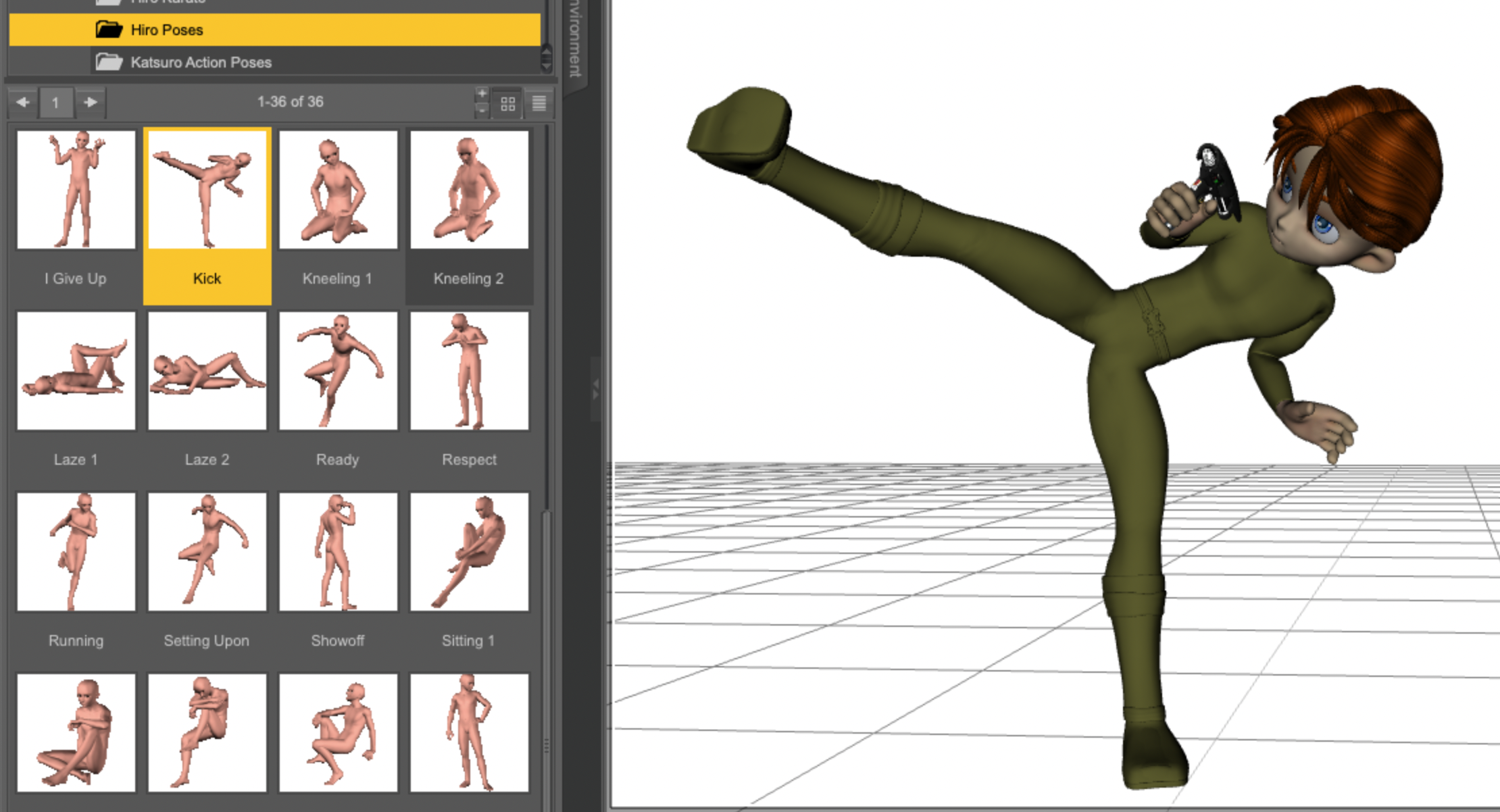

  • wsterdanwsterdan Posts: 3,281
    edited January 2024
    For poses, older figures like these tended to use the same skeletal set-ups as other older figures, in this case like Micheal 3/Victoria 3/Aiko 3/Hiro 3/etc.
    Attached are an M3 pose and two Hiro 3 poses used, showing how closely they work without any editing (I tend to shrink the Cookie and Chip heads when I use them, but the poses didn't affect them).
    If I recall, these used to be RDNA characters and didn't hit the DAZ store until DAZ bought the RDNA store. You'll find more custom clothing from other stores, check the usual places.

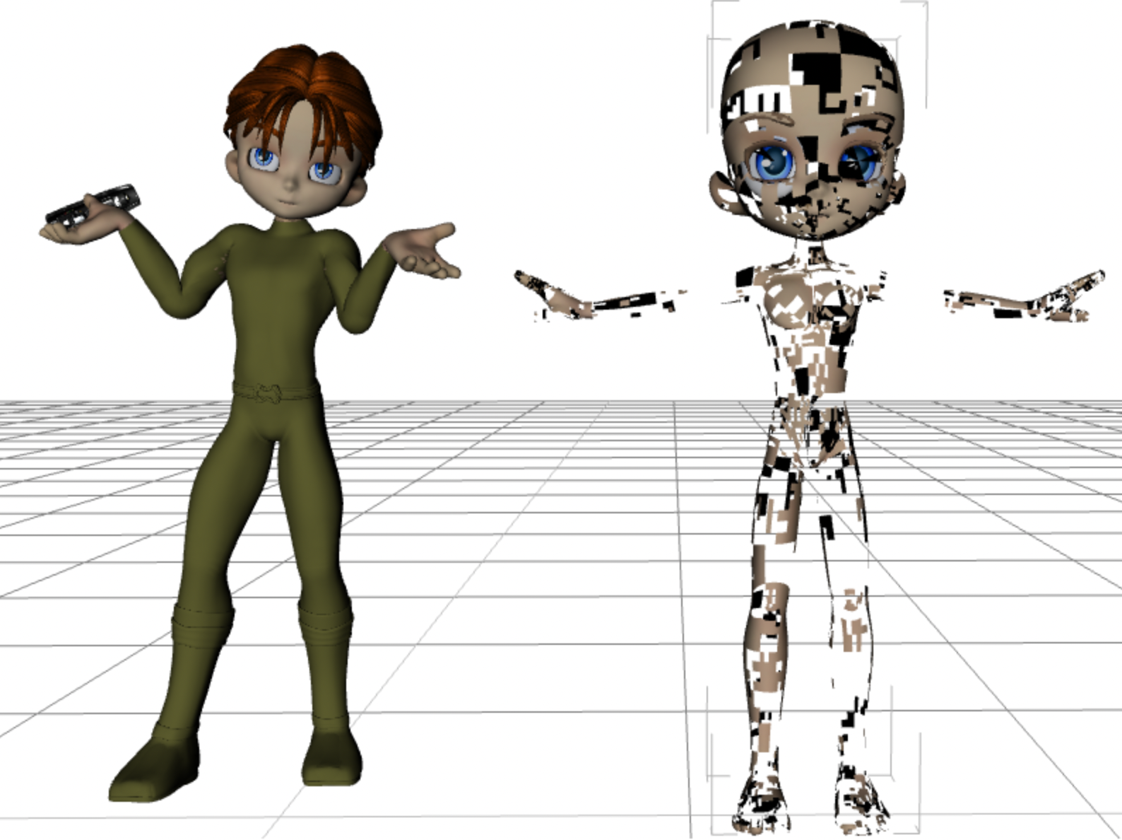

    Chip and Cookie come with "heads" that you used to be able to load and use with other characters' bodies (by hiding the other charcter's heads) but the Chip head stopped working a while ago, I'm not sure in which DAZ Studio version. When you load the "head" now, you get the mess attached.

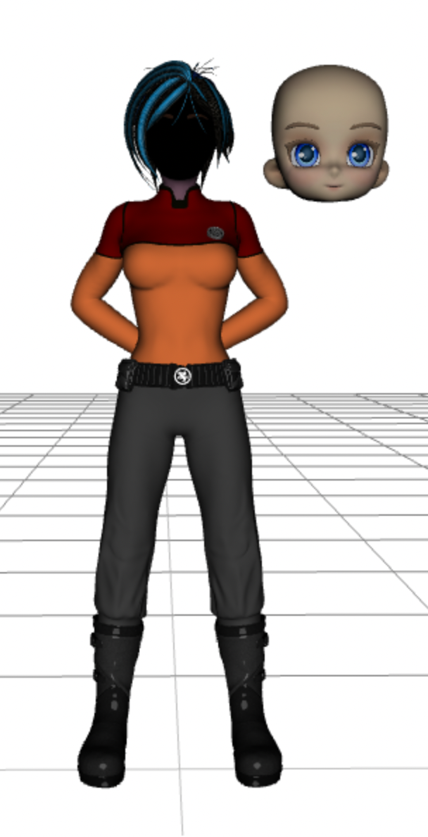

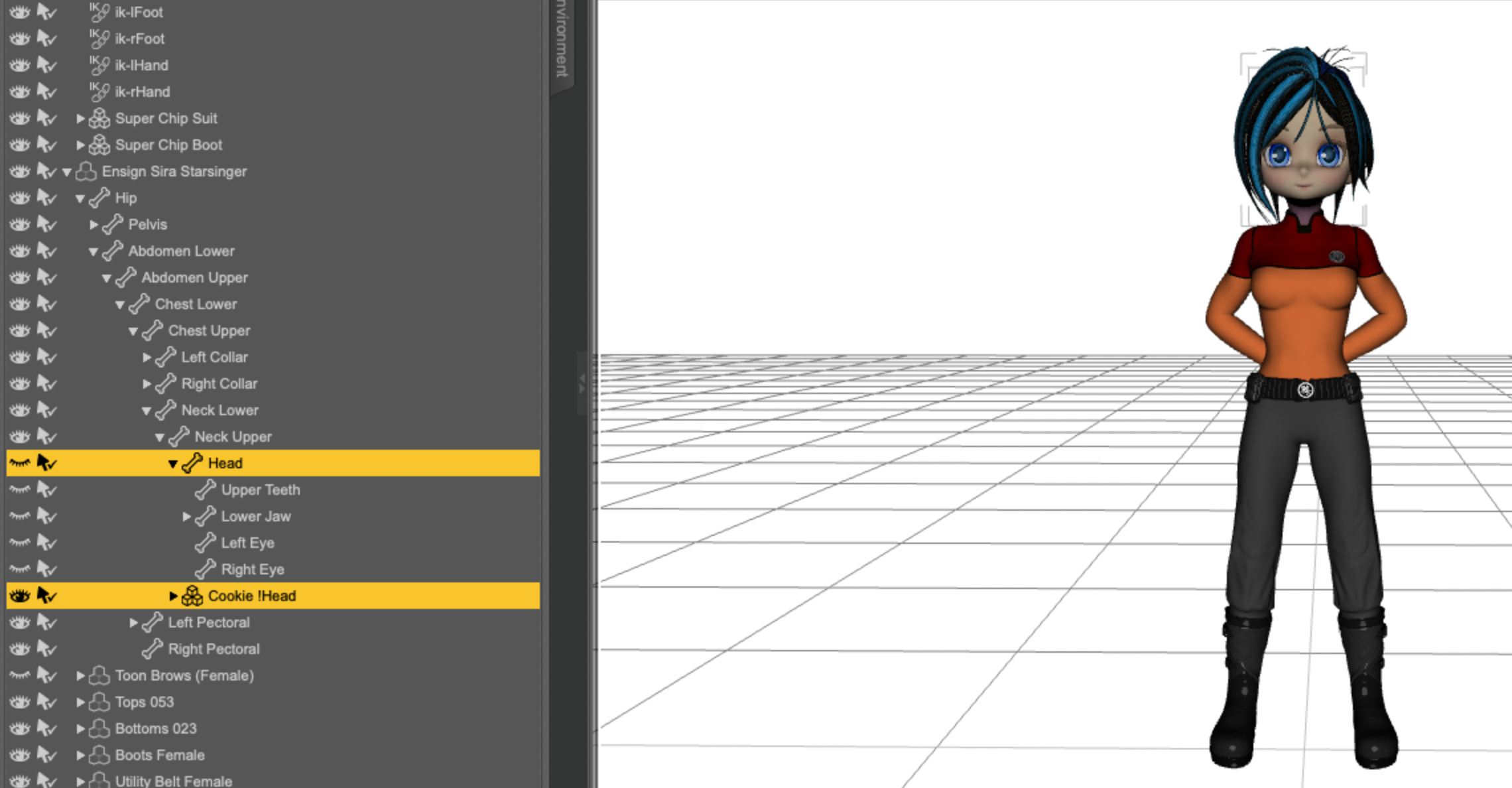

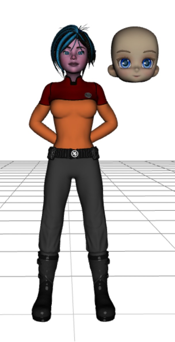

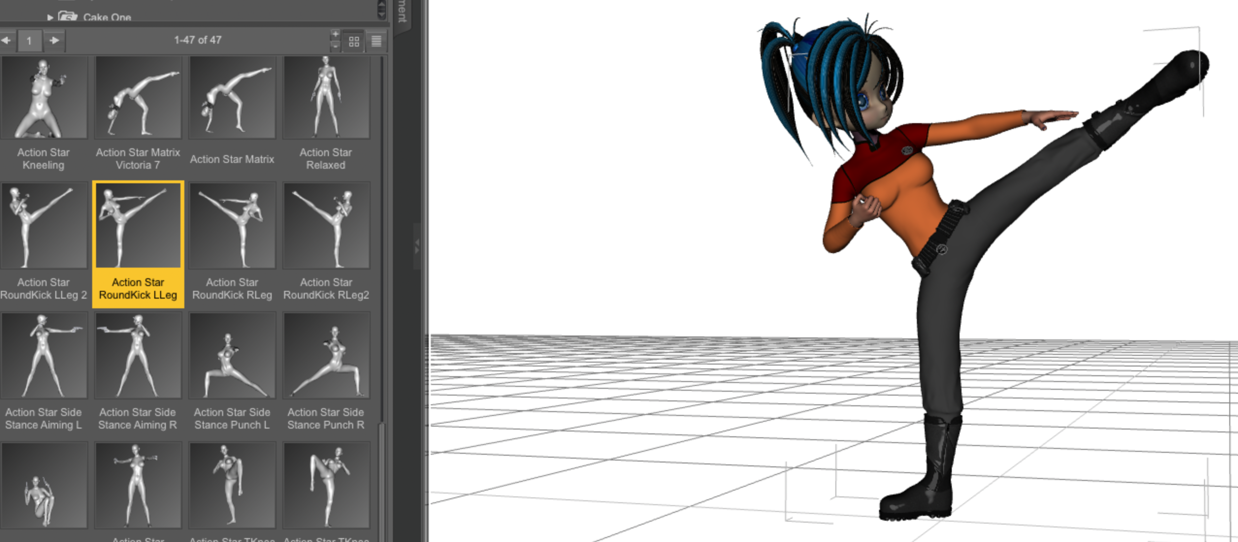

    As FenixPhoenix wrote, one way is to attach Cookie's head to another body whose head is hidden. If you "attach" the head properly, it shouldn't split off when a pose is applied.
    Rather than add Cookie then hide her body, you can load just Cookie's head (Chip's doesn't work, as I mentioned above).
    Here, I've loaded a G3 character with some Toon Generations 2 morphing (FenixPhoenix's excellent idea of dialing in more Toon Gen 2, 3 or 4 morphs would make the overall character more toonish) and beside it, Cookie's head.
    I first hide the G3 character's head (including the eyes, teeth, tongue, etc.), then move the Cookie head into place (as noted, I like to shrink Chip and Cookie heads a bit); I used the hair I was already using by parenting it to Cookie's head and resizing it, then moved the Cookie head into place above the G3 upper neck.
    Once the Cookie head is where I want it to show, I parent it to the G3 body (in this case, the upper neck). You might get better results if you parent the Cookie head to the G3 head, it only takes a few seconds to switch it.
    Attached is a sample of a female G3 pose applied.
    Hopefully this helps a bit, let me know if you have any questions.

    Oh, glad to know it's not just something bad on my end that made Chip's head become unusable. I am getting the same result as you attached, where he looks like he is missing geometry all over.
    Nope, it's a problem with the geometry.
