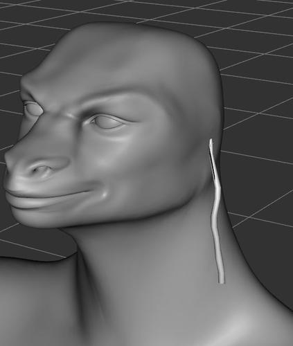

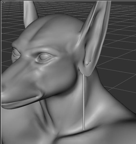

    For example, heer I created a really finely detailed earring and used the Transfer Utility to rig it for Genesis. As you can see, with no Rigidity Map applied dialling up the RawArt Drakon has badly warped it. But if I then select the whole Cylinder and assign it to a new Rigidity group, LEar, and then select the top of the cylinder and assign it as the reference for the group, dialling up Anubis scales the earring up to match Anubis' ears, but doesn't distort it.

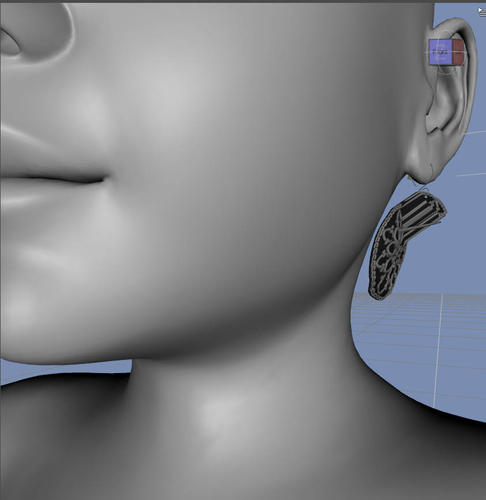

    Yeah. Sorry I re-read your last reply. This is what happens. When it goes from default Genesis down all the way to the little girl shape.

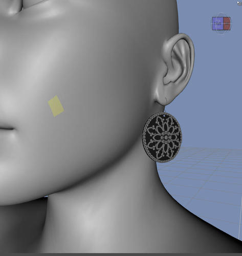

    This is what it should look like.

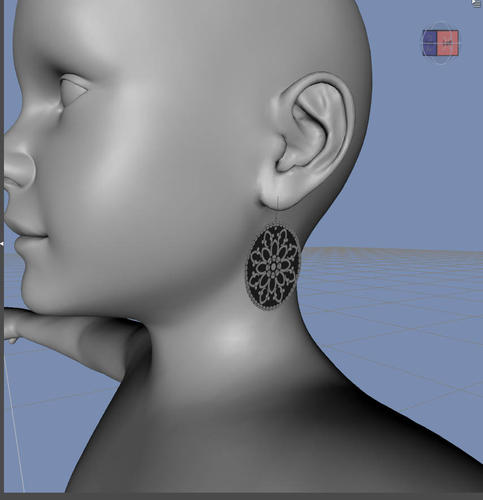

    Ok. I think I've got it now without the other (bad) distortion BUT there's seems to be yet another hurdle. The shape is now turned into an oval instead of the original circular shape of the earring after going through the full change down to the Basic Child.
    1. I selected the whole earring.
    2. Polygon Assignment ---> Create Rigidity Group from Selected ---> Create the rigidity group name
    3. Select a small polygon at the very top of the hook of the earring.
    4. Polygon Assignment ---> Assign to Rigidity Group as Reference ---> Select the group name
    I was even able to create a Rigidity Map as well this time. Didn't do much with that since I really have no idea what to do with that. Doesn't work pleasantly either trying to brush over the surface with the brush tool. Kind of difficult to see as well.
    The outcome of that is shown below:
    855 x 885 - 66K

  • Richard HaseltineRichard Haseltine Posts: 111,332
    You may need to select a different reference polygon, as I understand it the whole mesh is transformed as the reference polygon is (which is why, in my example with Anubis, the cylinder gets longer - but it doesn't obviously distort the shape, being just a simple cylinder). The alternative would be to create a gneuine child morph - just export the mesh as it is, rescale it, and load as a new morph target to replace the auto-generated one..
