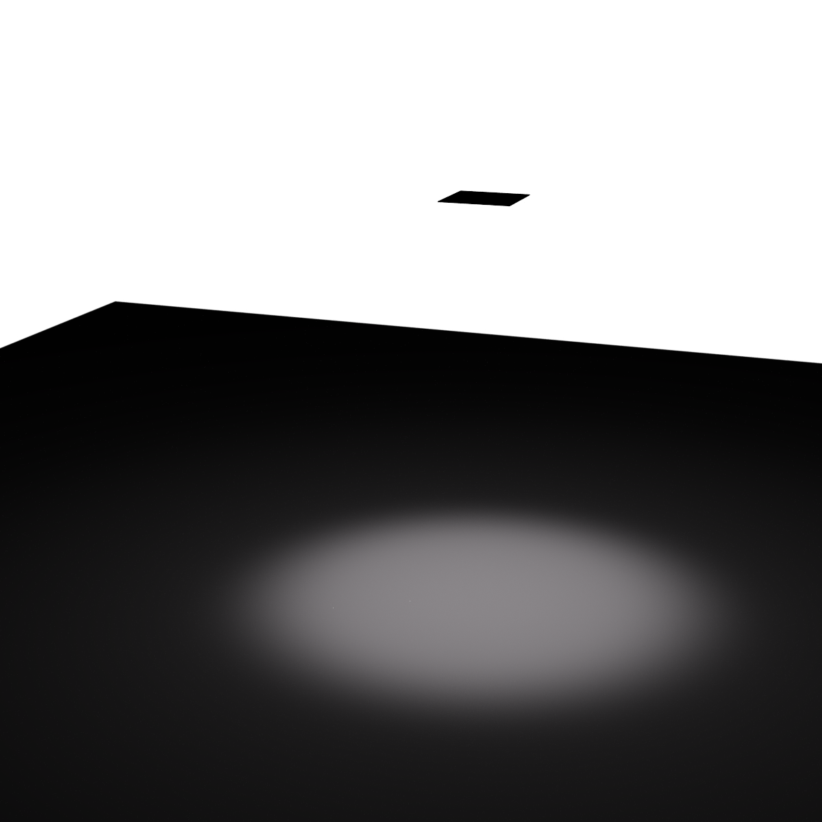

  • felisfelis Posts: 6,502
    edited January 2024
    I created a plane with Z forward, but I had to rotate it 180 degree, to get it right.
    Edit: which corresponds to the axis orientation in blender.
    1200 x 1200 - 412K
    Post edited by felis on
  • Sorry, Z backwards was what I should have said
