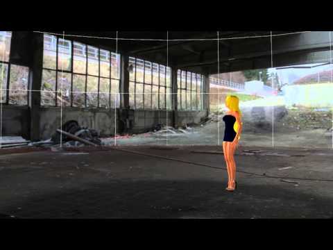

iRay rendering Environment domes using the mirror ball trick
Chasm iRay rendered using the mirror ball trick

this image shows that we must not render the whole surface of the mirror ball in order to get the hemisphere
and here you can see the settings i used to transform from the mirror-ball to the cylindrical format
