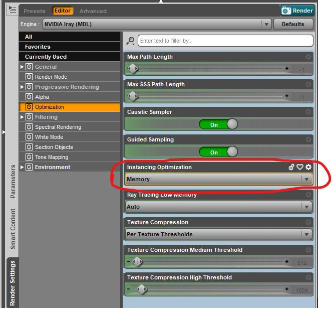

  • Try chnaging the Instane Optimisation in Render Settings>Editor.
    edited January 2024
    @quasimondo1933_d9c60fcfb4 This is what Richard is referring to (see screenshot). Just toggling the Instancing Optimization from one setting to another causes some values to be recalculated and fix some problems like that. It is not that one setting is better than another, it is the act of changing it that is important. You can even set it back to your original value if that is important to your work (like scenes with thousands of instances usually need to be set to Instancing Optimization Memory, not Speed).

  • That did the trick.  Oddly enough, the opacity issue still pops up in the preview, but as long as it doesn't affect the final product, you have my thanks.
    Thanks for letting us know that worked for you. It is a handy trick that helps when eyes look black, too. Keep it in your bag of tricks for future problem solving.
