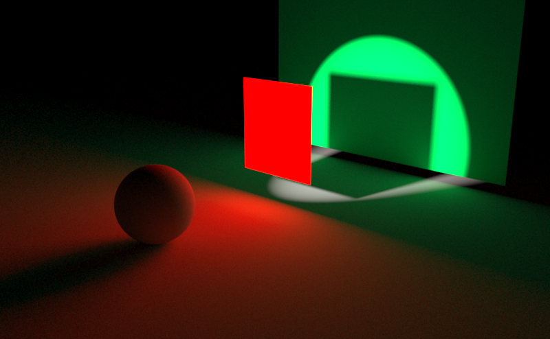

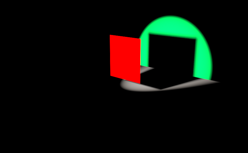

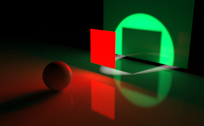

...so I made a series of demo-renders, much easier than trying to explain;)
There's the aweEnvironment with a pitchblack env. sphere that does not contribute to the lighting, a ds standard spotlight with pure white light, physical falloff and raytraced shadows, aimed at the red plane but slightly overlapping to partly illuminate the bigger green plane. Also a ground plane and a sphere with an almost white diffuse color. Diffuse roughness is 0 on everything, so pure Lambert diffuse here:
DD0 RD0 = no bounce light no reflections, only primary rays
DD1 RD0
DD3 RD0
DD16 RD0
DD3 RD 16
My conclusion: The difference between DD3 and DD16 is smaller than one would think, which means wowie did a great job under the hood, optimizing his stuff for speed.
DD1 RD0
DD3 RD0
DD16 RD0
DD3 RD 16
DD1 RD0
DD3 RD0
DD16 RD0
DD3 RD 16

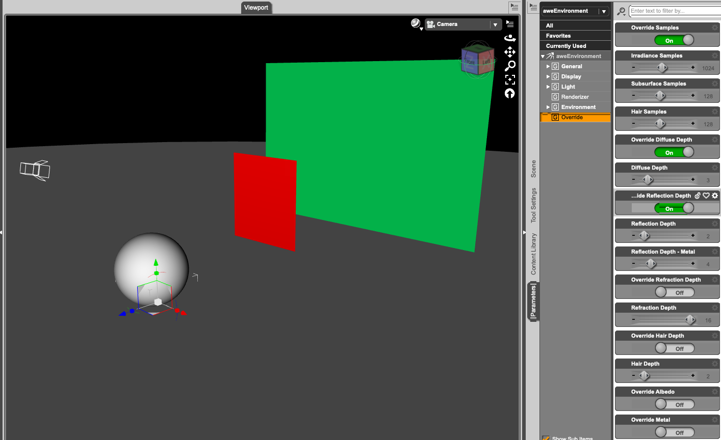

and also, the surface that's being used for the green wall in the test render, how do i apply it to every surface in the Shaded Haven
how do the surface materials compare to the one used for the central stone wall in your Shaded Haven render, the wall with the tap in it
The surfaces in the testscene were just the aweSurface default with a generic diffuse color using the color picker, and the default specular roughness is 1%, with 100% reflection strength, (I dialed back a bit on reflections here). The SH stonewall I set to maybe 30% roughness and maybe dialled in some diffuse roughness too. 0% roughness equals perfectly sharp reflections, which should be used only for extremely glossy surfaces like mirrors, smooth metal and glass/water. Most surfaces use values arond 15-50%, think asphalt, stone walls, sand, fabrics etc.
And then there's the Glossy Freznel slider which is linked to the IoR (index of refraction) value, which makes surfaces at a grazing angle more reflective, the smaller the freznel roughness is set to, or the higher the IoR:) Read the manual;) Anyway, most dielectic materials use an IoR of about 1.5. Fabric is different, usually very rough with a rough glossy freznel, and a lower IoR.
.. Select all surfaces, remove all maps, tint the diffuse color green, reset every parameter I used to the default state by alt/option-clicking in the appropriate channels. OR create a primitive plane, select it in the scene pane and its surface in the surface editor pane, apply aweSurface, tint it green, right-click anywhere in the surface pane to bring up a "copy selected surface(s)" menu, then hide or delete the plane, select all surfaces you want green, right-click again and paste to selected surface(s). There are probably several other options, like saving the green as a shader preset, which then can be applied to any surface in future projects.

Yes, diffuse- and specular roughness are important for defining how lightrays react to the surface. Also bump-, displacement-, normal-. IoR-. and GlossyFresnel roughness settings will have an impact.
so hope you don't mind if i ask, what are the values of the light-scattering parameters of the green wall, and how do i input changing the light-scattering parameters of the Shaded Haven surfaces to match those of the green wall
As I mentioned, I just used the aweSurface defaults with a 0% diffuse roughness and a 1% specular roughness. This is what you get if you go to file menu/create new primitive/primitive plane, select the plane in the scenetab and its surface in the surface editor tab, then go to your ContentLibrary/shader presets/wowie/awe shading kit and double click the aweSurface icon. Then go back to the surface tab, find diffuse color /white by default), click on the color field to open the color picker and pick the color of your choice.
To save that as a shader preset, have the plane and its surface selected, save as shader preset.
To apply the shader preset to all surfaces of Shaded Haven, select the Pergola and its surfaces, doubleclick your preset.

Right, I'll try to explain: Every surface can use their own trace settings if you wish. Example: You could use a higher trace depth on reflective surfaces and a lower for fabric and other very rough surfaces. (The same goes for Irradiance samples, saturation, tonemapping and temperature). This is all done in the surface editor, and allows you to manually optimize your scenes for faster rendering, if needed. As always, quality vs rendertime. So, if you set trace depth for a surface to 16, but in rendersettings you have specified 12, 12 is what you get. if you have specified 16 in rendersettings but 12 in surface settings, 12 is what you get.
Now, have a look at the awe Environment Light. This provides a very easy way of adjusting all this globally, instead of having to type in values manually for each surface. Simply go to the Override section of the light and enable overrides for Irradiance(shadow)samples, SSS samples, aweHair samples, diffuse depth, specular depth, metal depth, hair depth (for the aweHair shader), type in the values you want to use, done. If you still would like to use a different value on some surface, you can override the aweLight overrides in the surface editor.
This is how I do it, so I used the aweEnvironment light overrides in the ShadedHaven scene. Feel free to use the overrides or disable them and set them per surface instead! And again, if your rendersettings values are smaller, that's what will be used for the final render output.
And a general note: Wowie's default settings do make sense. Raising these numbers a lot will not automagically make the render photoreal. It's also very much down to the quality/resolution of textures, the topology, the lighting, the environment etc. A metal object in a dark room will be dark, no matter the number of bounces.
Diffuse Depth 3, Reflection depth 2 (wowie's defaults)
DD1 RD0
DD3 RD0
DD16 RD0
DD3 RD 16
