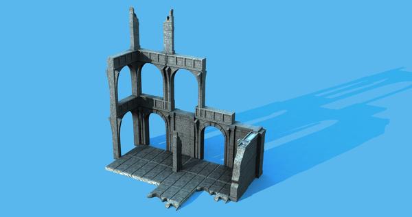

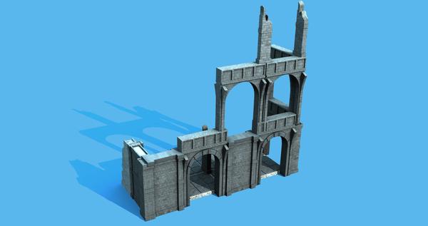

Here is what I'm trying to do: I am creating some props for my 3D comic and also for a free "give-away" to DAZ users. I've included some shots of the pieces I've already knocked together, and an quick example of one possible arrangement. The modeling, UV mapping, and surfacing aren't a problem. The whole thing, unfortunately, falls down on import into DAZ.
Okay, here is what I'm doing:
1. Export model (which has UV maps and associated image files located in the object location) to an OBJ.
2. Import the OBJ into DAZ Studio.
3. Model loads fine, but no UV maps are found.
I've tried this both as one massive OBJ file, and as individual pieces. I never, ever get the UV maps to come across.
At t his point I'm at a loss. The UV maps are there, but DAZ will not read them.
Any help would be appreciated.
Thanks!
Avindair

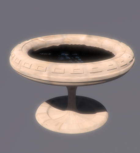

    Thanks for the suggestion. Now I have a new issue: When I select a surface on the imported OBJ and scroll down to the "UV Set" drop-down, there is nothing to select. Yet if I select the "UV" view, I see the UV for the WashBasin.
    Allow me to be the first to say "HUH?!"
    So...the UV is there, but not selectable. What the heck?
    Again, any help would be appreciated.
    There is a drop down menu in the surfaces tab at the right hand side, looks like lines with a triangle, and you can use the option to 'Load UV Set' in there. I know that there was a problem in one of the earlier versions, but I hope it is working now.
    Let me know how you get on :)
  • Tony BrunoTony Bruno Posts: 28
    Thanks for the heads-up on that feature! As it was, I took a chance and just started applying surface information from the image files. Sure enough, it worked with the UV maps that, apparently, were already there. Not named, but there.
    Weird.
    So, surfaced up a couple of pieces, and shot some test renders. Now if I can only remember how to save these objects as DAZ files I think I'll be golden.
    (Aside: Yes, there is UV stretching on the basin. It was a quick UV to test this problem. :))
