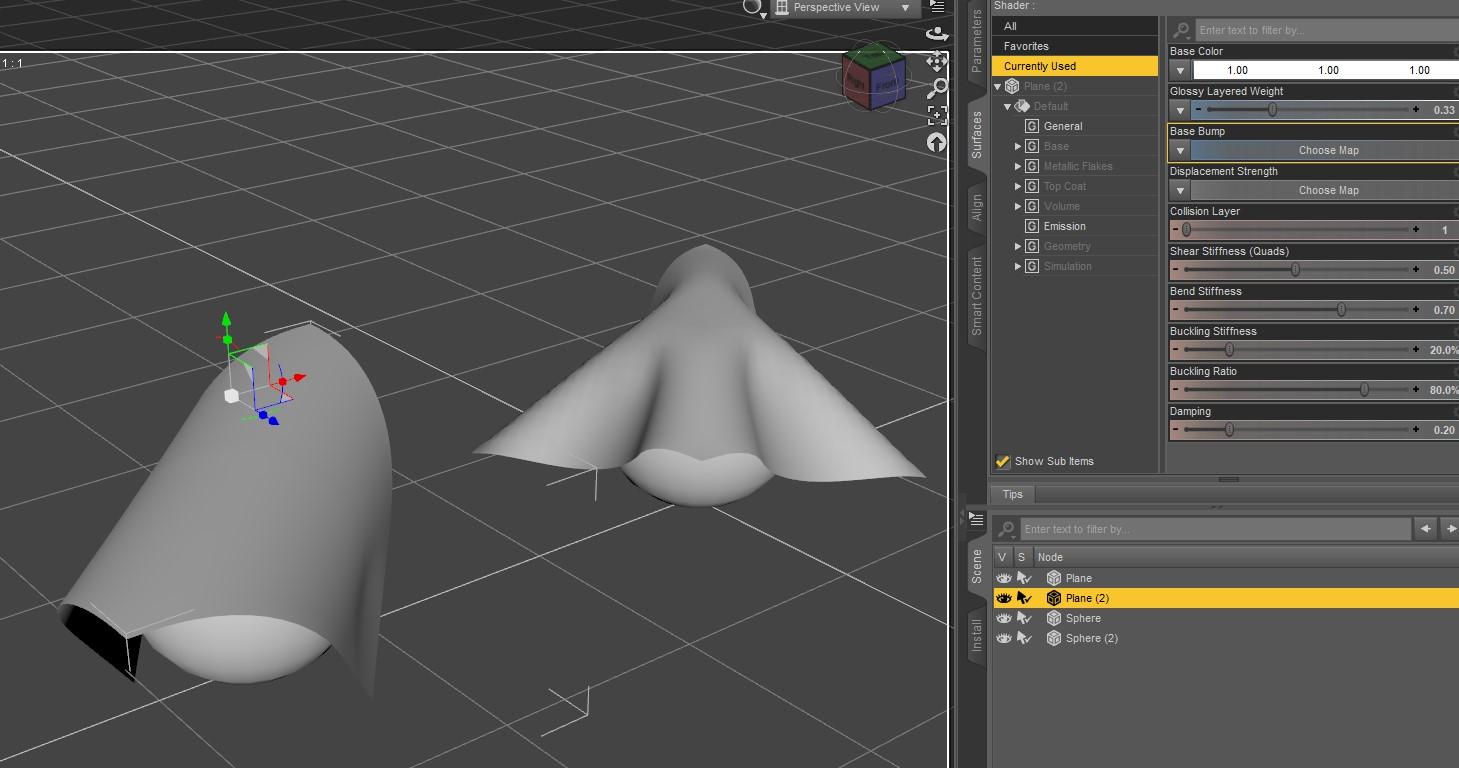

    Just a quick test using a 25 division plane (because I hit enter too soon, though for stiff fabrics you want to limit the divisions if you can) - the Surfaces pane shows the values I changed for the plane on the left of the image, and i gave it 32 subframes and 5s stabilisation time too.
    1459 x 768 - 160K

    Yes, 1st of all, pls don't add too many divisions. As an alternative, try with Buckling Stiffness only, or Bucking Stiffness + Velocity Smoothing. The latter can significantly make the surface more rigid.
    The examples below are with a primitive plane of 40 divisions. 1. Default draping 2. High Buckling Stiffness, 3. + Velocity Smoothing. You may further tweak the value to have more subtle change of draping result.
    2560 x 1400 - 426K
    2560 x 1400 - 428K
    2560 x 1400 - 412K
