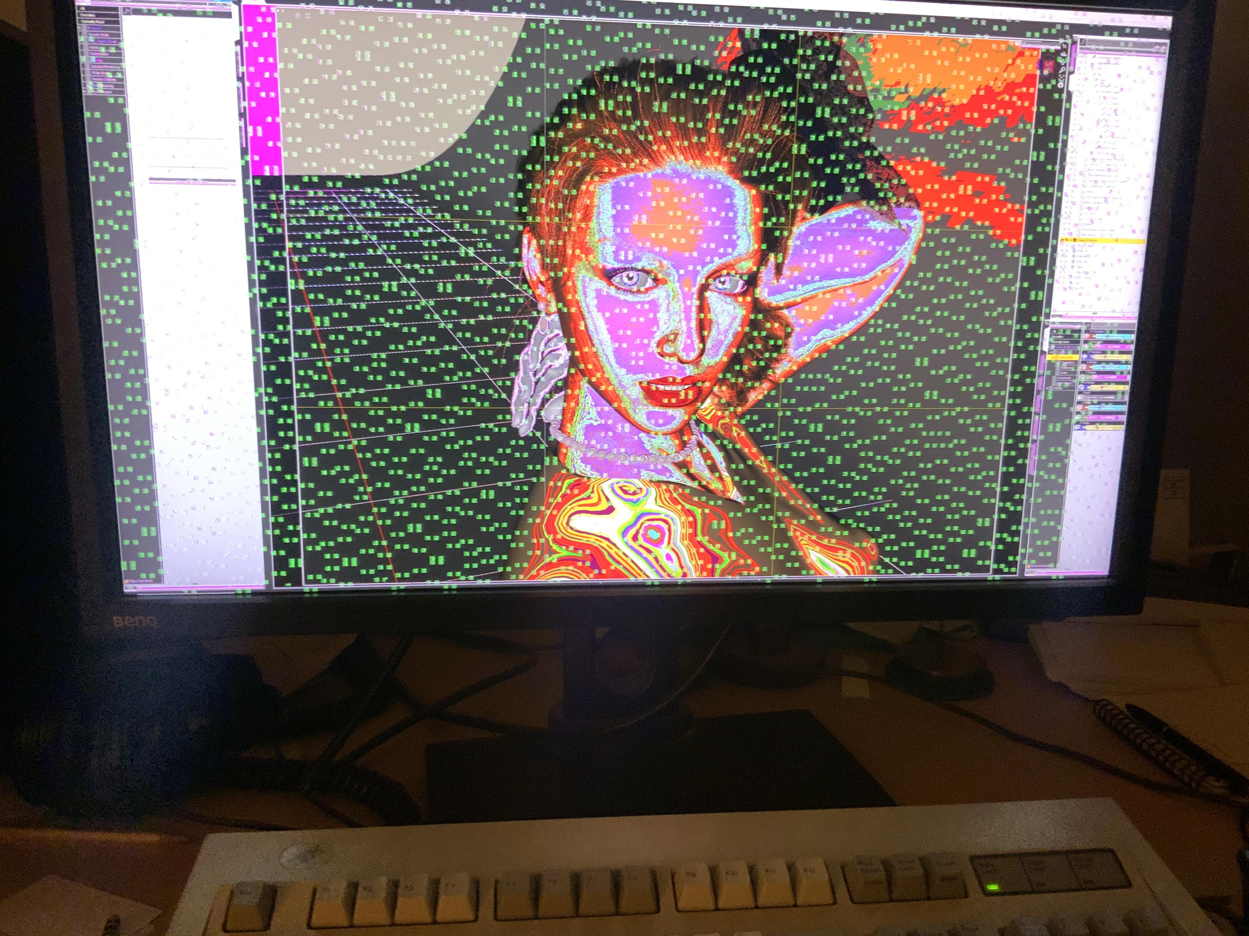

The fatal error happens so quickly, haven't been able snap a photo with iPad before Windows 10 shuts desktop down.    Difficult to describe.   Looks like streaming when wi-fi starts to lag.  Pixelate with small RGB squares.  Then the screen goes completely red-green-blue-white horizontal stripes & Windows 10 shuts it down in a few seconds.   Bought a replacement cable but didn't make any diff.

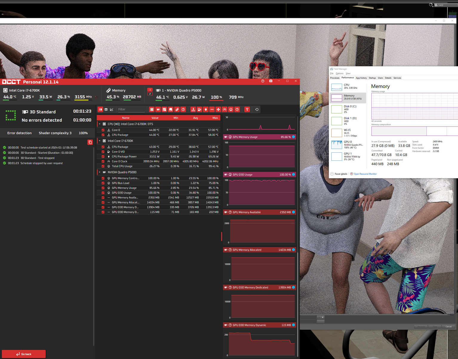

    Wow!  Just tried it and appears to give status on just about everything.
    Sample from DS 4.21 log file when I had the fatal errors.  1000s on lines to scroll through.
    example:
    "2024-01-11 20:01:35.169 [WARNING] :: ..\..\..\..\..\src\pluginsource\DzIrayRender\dzneuraymgr.cpp(369): Iray [ERROR] - PLUG:PLUGIN ::   0.0   PLUG   plug error: Library C:\Program Files\DAZ 3D\DAZStudio4\libs\iray\avcodec-58.dll: symbol "mi_plugin_factory" not found."
    Also something about an "illegal memory access" -- all Greek to me.
    Anyway, test render and OCCT didn't display any errors so hopefully rule out hardware failures. yes

    I got a photo of it at least.  Pretty sure p5000 is on its last legs.  Behavior is same in DS4.20, 4.21 and 4.22.  The photo is from DS4.21
    OCCT hardware test says no errors.  Skeptical or maybe that's not how it works.  Right in the middle of a render, fatal error.   OCCT is saying "no errors"   What?
