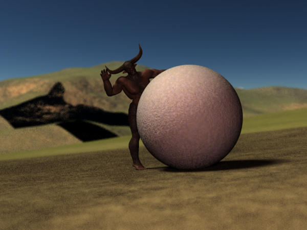

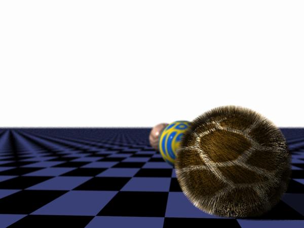

In the attached image I have the depth of field blur intensity set to the maximum of 400%. The defocused areas are not very blurry even at 400%. What attributes of my scene should I change to get greater blur? Thanks.
640 x 480 - 61K
Post edited by circular05 on

    Sounds like you're looking for a "shallow" depth of field.
    In the real world, depth of field is a characteristic of cameras and lenses. Cameras focus on a single spot, and anything that is closer or further away from that spot are out of focus. It's just that it's so gradual in a certain area (called the depth of field) that we can't see the out of focus-ness, but it's there.
    Anyway, since it's a function of cameras and lenses, you need to adjust the camera and lens in your scene to see the effect. One way to decrease the DOF is to increase the magnification of the subject (ie, the sphere in your image). How do you increase the magnification? Well, you move the camera closer to the sphere, or use a zoom lens (higher mm).
    The other thing that affects it is the aperture of the lens (ie, the f-stop). A bigger opening will give a shallower DOF than a smaller opening.
    In Carrara and many other apps, you can't really select the f-stop of the lens (though you can in some newer render apps, called "physically based"). But you can monkey with the magnification by moving the camera closer or selecting a zoom lens. But each of those two options gives different results, so see which one works best.
    Keep in mind that if you have the flexibility with your particular scene to adjust the distance of the foreground/background relative to the subject, that's another way to get differing blurs given an existing DOF. So if your camera arrangement has a 20 foot DOF, for example, then obviously moving stuff in the background to be 40 feet away rather than 10 feet away will give you a blurrier background. But that might get messy in the future if you want the distances to be accurate.
    And don't use the built in Carrara DOF, it's really, really bad. Use Photoshop or AE or whatever.

    By the way, it goes without saying, but I'll say it anyway...
    If the distance between foreground and background in your scene (eg, the cylinder in your image) is very short, then it's gonna be real tough to make it really blurry, because the DOF is just a distance, and if you have scene objects that are within that small distance, they ain't gonna be blurry.
    So if you put something WAY behind the cylinder that the sphere is standing on, it's easier to configure your camera to make that blurry.
  • circular05circular05 Posts: 0
    Thanks, JoeMamma2000. That is helpful information and makes sense to me. I like that the DoF option is there, though I agree that it is a bit basic. I bought a book on AE today so I will see if I can make some use of its DoF effect in my animations.

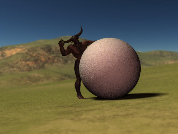

    Here's an example of the superior bad-ness of the raytraced DOF. First image was raytraced, second was post effect. No other changes between renders, just selected/de-selected raytraced DOF.
    First one took almost 8 minutes, second one took less than 10 seconds. And no, I have no idea what that weird black artifact is in the first image. Hence my proclamation that it's broken.

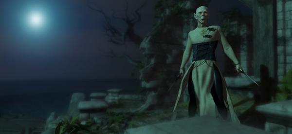

    I like the DOF effect I get in Carrara, but it does take a while to set up. The camera type and distance have a lot to do with it, and I tend to use spheres (that I delete befroe rendering) to get the right focus point.
    Also, I'll have to check to be sure, but I think you can type in any value up to 999 in the DOF value rather than use the slider.

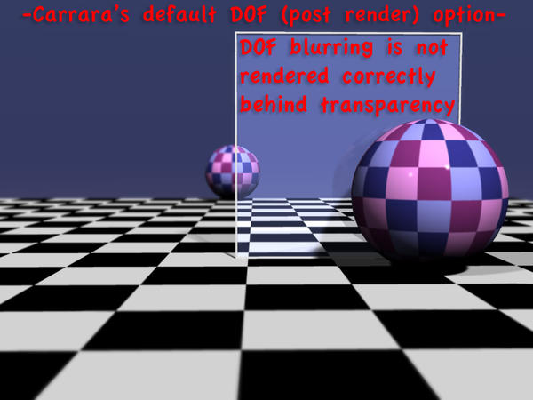

    In regard to transparent (and/or refracting) objects:
    The depth-of-field blurring that is obtained by using Carrara's default DOF "post render" option, or by using a depth pass render in conjunction with Photoshop's Lens Blur filter, will not render the DOF blur that occurs behind a transparency.
    However, Carrara's DOF "Raytraced" option will render the blur behind transparent areas. It's the only automatic way I’ve seen to render complete depth-of-field blur in such scenes.
    (Low quality settings were used in the following examples so as to expedite their creation. Smoother blurs are obtained with higher settings.)

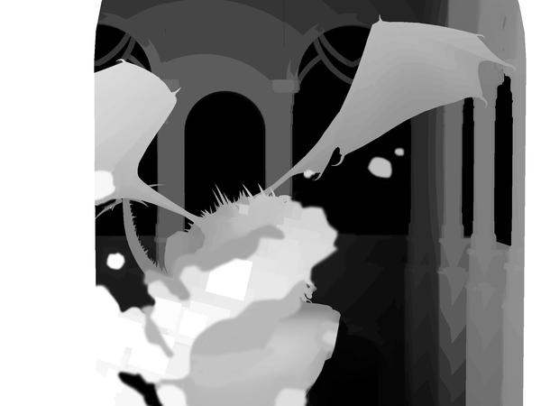

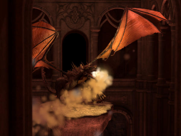

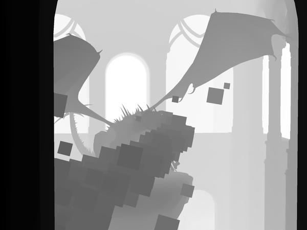

    Here's an example. I used the DOF in Carrara, but I also rendered a depth pass because I was aware of the issue with alphas and wanted to fix any artifacts in my particles as they used alphas. The first image (assuming they display in the order in which I upload) is the raw image, the second one is the raw depth pass, the third is the painted depth pass and the last image is the final version.
    I did invert the depth pass because I wanted the background out of focus as well. since I rendered a DOF with the image, it didn't hurt the foreground's lack of focus.
