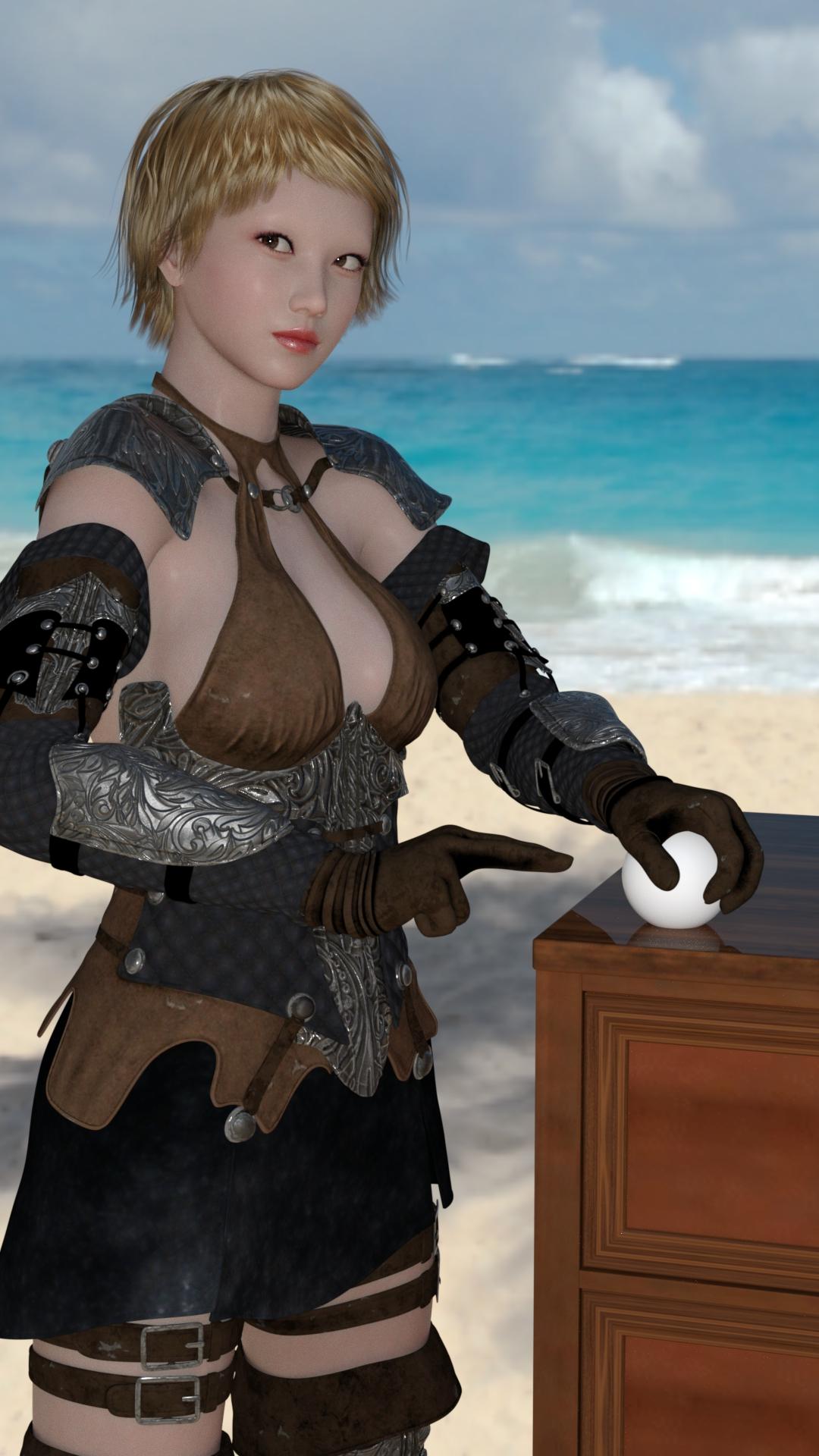

    mumia76 said:
    Hi, is this tool compatible with genesis 8? IYes've been trying it with that, and it refuses to work. It says I did not select proper nodes.
    yes it works with Genesis up to 8
    typical use
    there's a ball on the table and i want the right hand to grab it
    create a null node
    place it approximately where you want the hand (wrist) to be
    select the null node followed by the figure's rHand joint
    run the script mcjAutolimb2015
    click on the  DoIt button and the arm pose should change so that the wrist reaches the target location (null node )
    you can also select any finger bone or objects parented to the hand as the targeter
    in our example the targeter was the figure's hand
    but it could also be a null node parented to the point of a sword which is parented to the hand
    this way you could select the ball(target) followed by the null at the point of the sword (targeter)
    and mcjAutolimb will pose the arm so that the point of the sword reaches the ball
    1080 x 1920 - 975K
