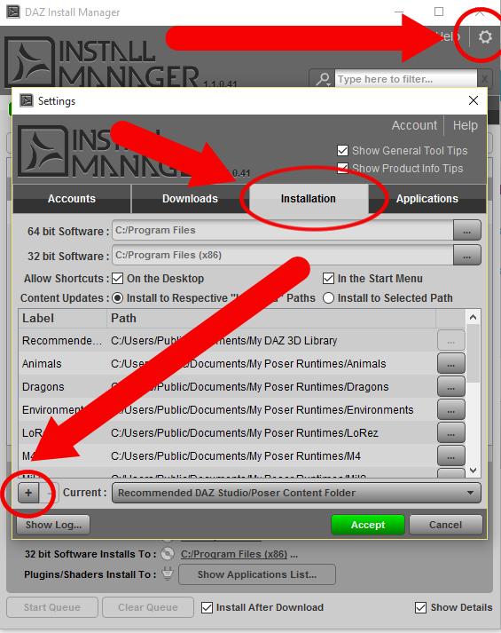

    It's really easy and convenient to use DIM to organize content.
    In this image, I'm showing you where to go in DIM to add the locations where you'd like you content to go, which will create selections when you download/install your content.
    DIM Settings (Gear icon upper right) > Installation Tab > "+" button to add a new path. In the next image we'll look at installing.
    This Image is showing the bottom of the main page in DIM.
    In your Downloads and Install tabs keep "Show Details" checked, which will reveal a drop-down list of your stored locations.
    Then you simply select a specific location, check items you wish installed there and start the queue... simple!

    Thanks for the tips! Just set DIM to point to a folder on WD drive. What's the difference between install to respective or selected paths?

    The difference is that 'respective paths' will automatically install upgrades to the same place you've installed the original. This way, 'selected' option will allow you to install an update to a path you select from the drop-down instead. Not sure why... but there you have it ;)
