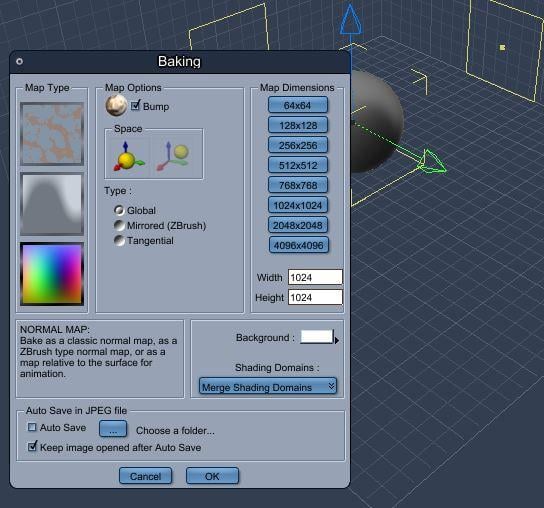

    I also have another option that I haven't tried yet... but will be:
    A while back I've purchased Inagoni's Advance Pack, which includes "Baker". With that, we can make procedural shaders in Carrara and export any of the channels as image maps. I can't remember if it will export Normal maps, or if it only allows for import of Normal maps (from back before Carrara gained that feature). But there's something about Normal maps in there. But Carrara's procedural shaders, I've learned, are very powerful for making textures. Just check out evilproducer's and Idigone's shaders for DAZ figures for an example of what can be done simply using a compilation of procedural functions. So then Baker can take the information that's being applied to the model and export it as image maps. This includes baking shadows onto the texture if that's what you want. But it will export color, highlight, shininess, bump, alpha... all sorts of stuff. It's been a while since I've read up on it though.
    Baker page at Inagoni.com
    Ha!  I have the baker plugin - I've even used it a few times but it never occured to me that it could do normal maps - and it can!  Screenshots of the interface attached; the second one shows the normal baking options.
    baker options

    See? Give Carrara and its tools a shot, since you already have it. On that note, however, with that Indie license being as mentioned by aspin above, that's a huge deal to get tools that are so up to date with the latest and greatest possibilities. Allegorithmic is certainly at the top of all of this, it seems. When it comes to materials, we can use all the help we can get. One of my favorite aspects about Carrara is how we can make our surfaces look very much however we want/need them to. No having to study which node to apply to what in order to jack into that and then inverse it and run it through this. But we can certainly do all of that by nesting parameters into our channels. Carrara's texture room, to me, is like a nodal system that has all of the main architecture already pligged in and ready to go, even though many of those nodes are empty. So we fill them with anything we want and Carrara renders it all out beautifully.

  • Meshlab is another way to bake highpoly mesh as normals on a lowpoly one the same shape and UV mapping
    its free at least

    Carrara's built in 3D painting allows you to paint directly onto a model,. it can also create other maps such as Bump and Specular,
    The Vertex modeller, allows you to paint fine Displacement details onto a model, which can be exported as a Displacement map.
    You don't neccesarily "need" to paint or sculpt directly onto a model to be able to generate Normal maps,.. or any other type of map
