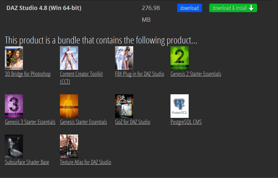

    There are 3 different Genesis starter essential packages now
    Genesis Starter  Essentials
    Genesis 2 Starter Essentials ;- which contains G2F and M2F installers
    Gensis 3 Starter Essentials :- which contains G3F and M3F installers.
