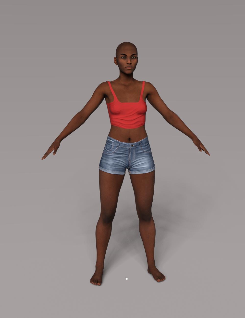

    I tried opening a ticket about this in January 2023, but it has never received any response or reply, despite my following up on it every few months.
    After being loaded into a scene and rendered in Iray, some shaders reproducably experience noticably different results based on which frame of the timeline Daz Studio is rendering. These shaders only appear to work correctly if loaded as part of the initial scene load. Put differently, load a scene with Jada 8.1 in it, and it's fine. But add Jada 8.1 into a scene, and this bug occurs until the scene is saved and reloaded.
    This is an extremely tedious problem, as my standard practice is to build my scenes on Frame 30 (as this gives me space on the timeline if I need to later set up a dForce timeline, without any hassle with moving around frames), and the workaround can take several minutes to save and reload a scene before I can correctly render or preview it.
    So far, the shaders I have noticed this most prominently with are PBRSkin (most obvious on dark skins) and UltraScenery's custom shader, but they're affected so differently that I do wonder whether it's a universal problem that instead affects less commonly used or less noticeable parameters on other shaders.
    On PBRSkin, Jada 8.1's skin for example gets - for lack of a better word - "Flatter" as the timeline progresses:
    Frame 0:
    Frame 15:
    Frame 30:

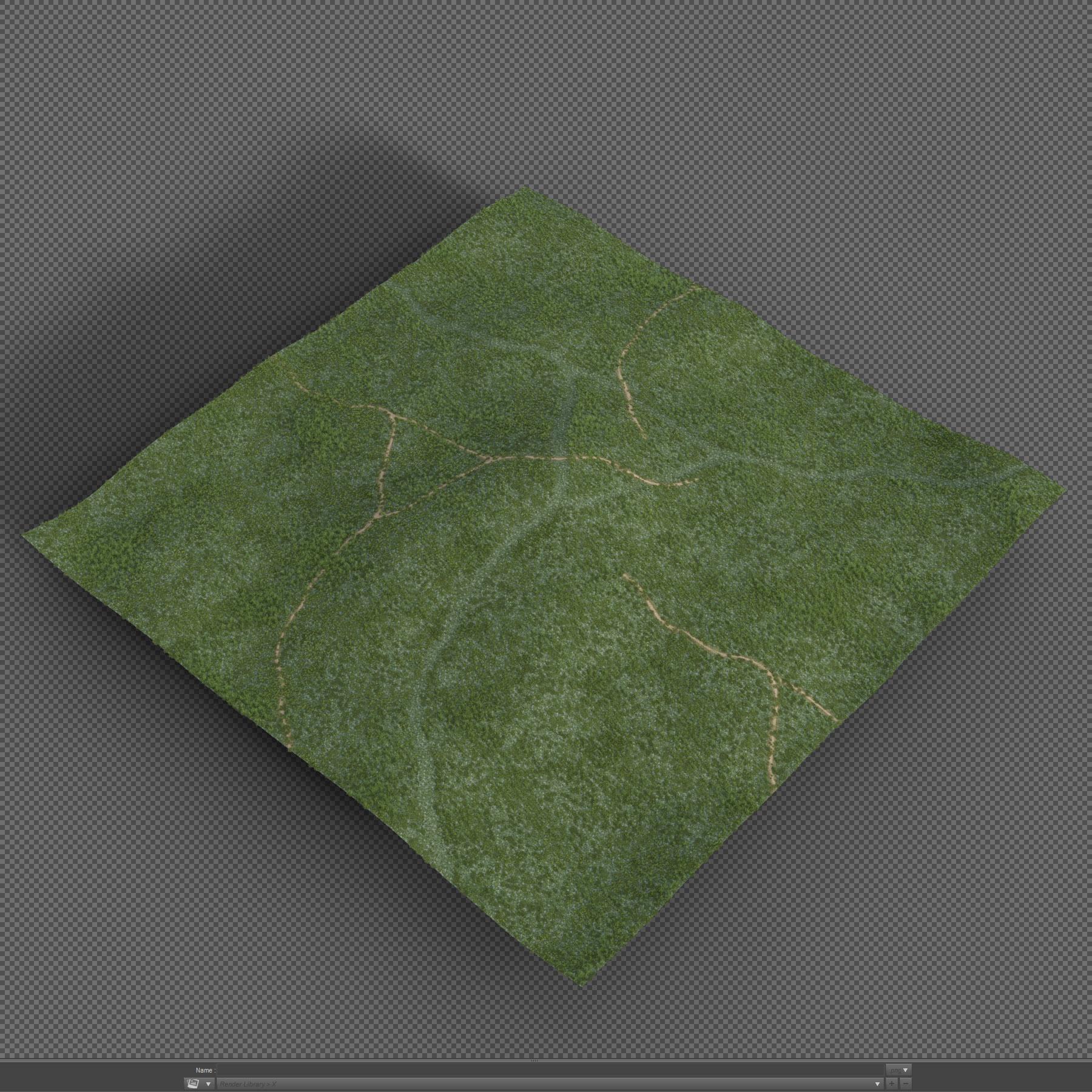

    The UltraScenery tiling problem on frames other than 0 is something I have seen, too. I posted about it a long time ago, but I can't find that message now. I think HowieFarkes said he didn't know what caused that to happen. He uses custom terrain shaders, so I don't know if that has any impact or not.
    Customer support for technical problems is no longer very useful. I've experienced delays of many months with absolutely no response at all, just like you have. Richard Haseltine has posted that adding comments to the help request can further delay it my pushing it back to the end of the queue. So, you might be better off just leaving the help request as it is. I've also had the repeated  issue of some of my help requests being closed and marked "Solved", without any resolution to the problem at all, just because they get old. It infuriates me that Daz can calls this customer support.
  • barbultbarbult Posts: 27,585
    edited May 2024

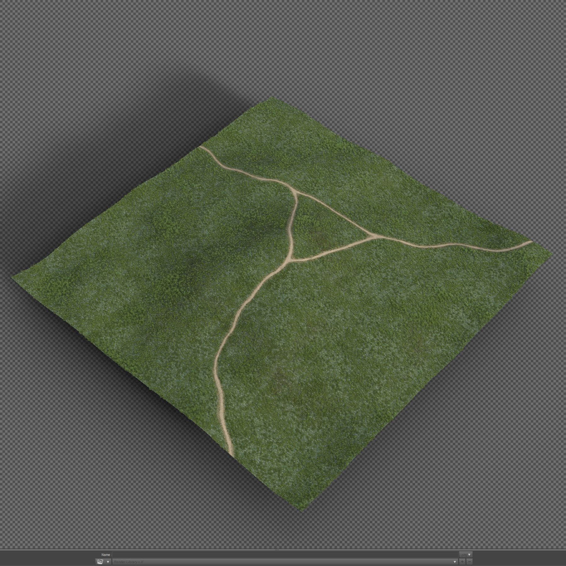

    Some observations about the UltraScenery tiling problem:
    • Not all UltraScenery features have the timeline tiling problem. The Walking Trail 1 and Walking Trail 2 features in Landscape Features Volume 2 definitely have the problem. But not all features in Landscape Features Volume 2 have that problem.
    • The tiling problem does not appear in the Texture Shaded preview. It appears when rendered (Iray is what i render with.)
    • The tiling problem seems to occur during the UltraScenery Build process.. Just moving to another frame after building the UltraScenery in frame 0, does not cause the tiling for me.
    • I seems like only the terrain feature is tiled. The ecology instances are not tiled. The terrain shape is not tiled. (I used a custom arrow shaped height map in the attached images. It was not tiled.)
    • This problem is not new in the 4.22.1.123 Public Build. It is most likely an UltraScenery problem and not a DS problem. I now believe this is a DS problem, after more thoroughly understanding Matt_Castle's bug report, and how it is not just UltraScenery that demonstrates the problem with shaders in timeline frames other than 0.
    1753 x 1733 - 1M
    1664 x 1716 - 909K

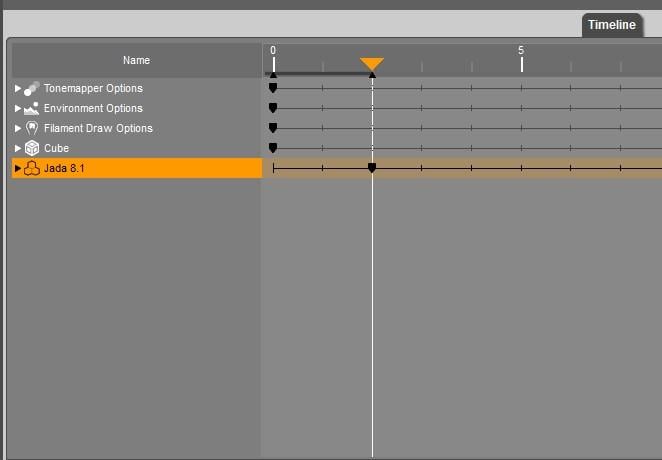

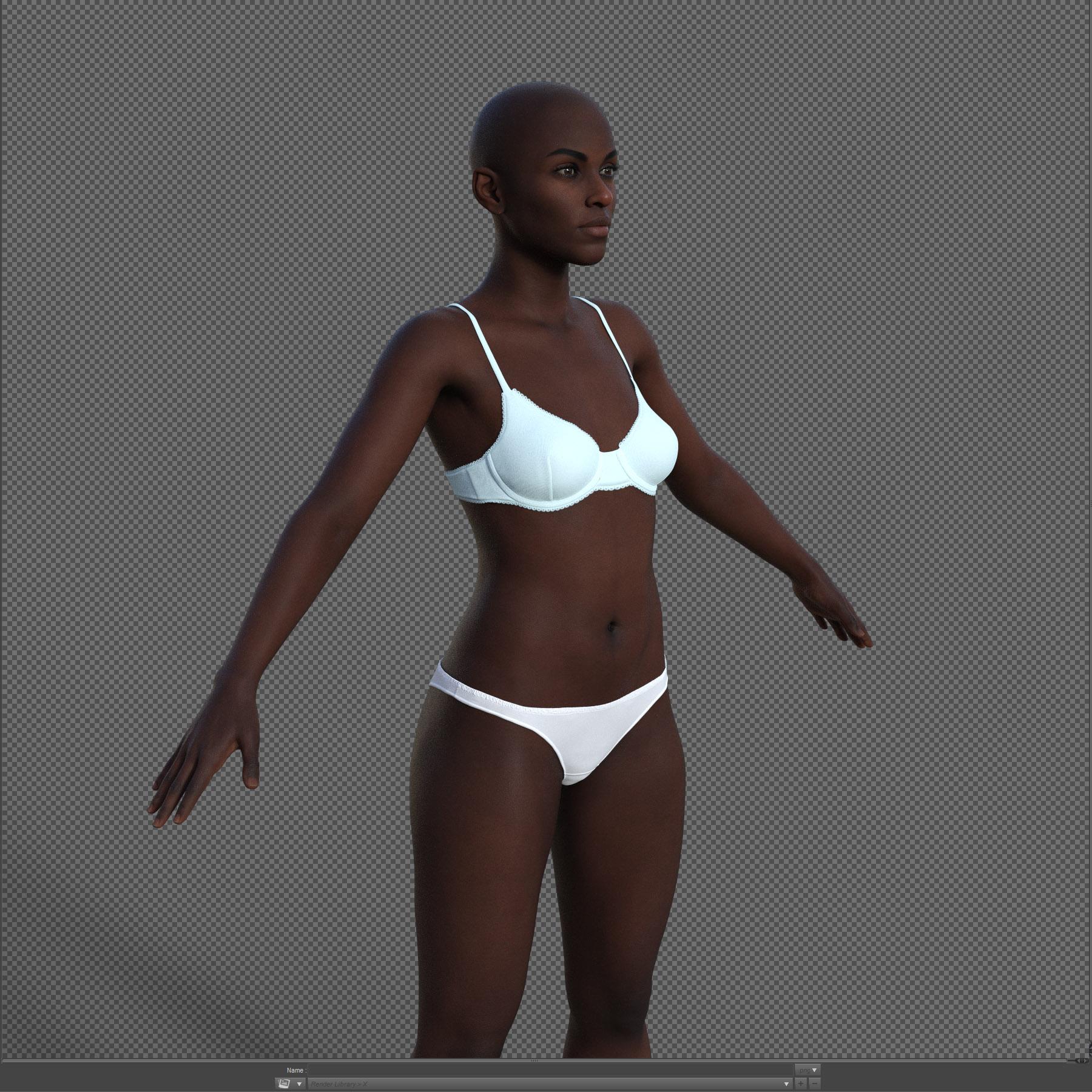

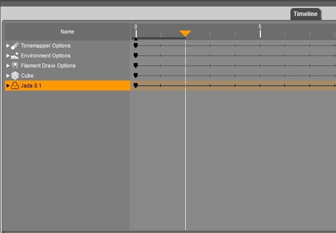

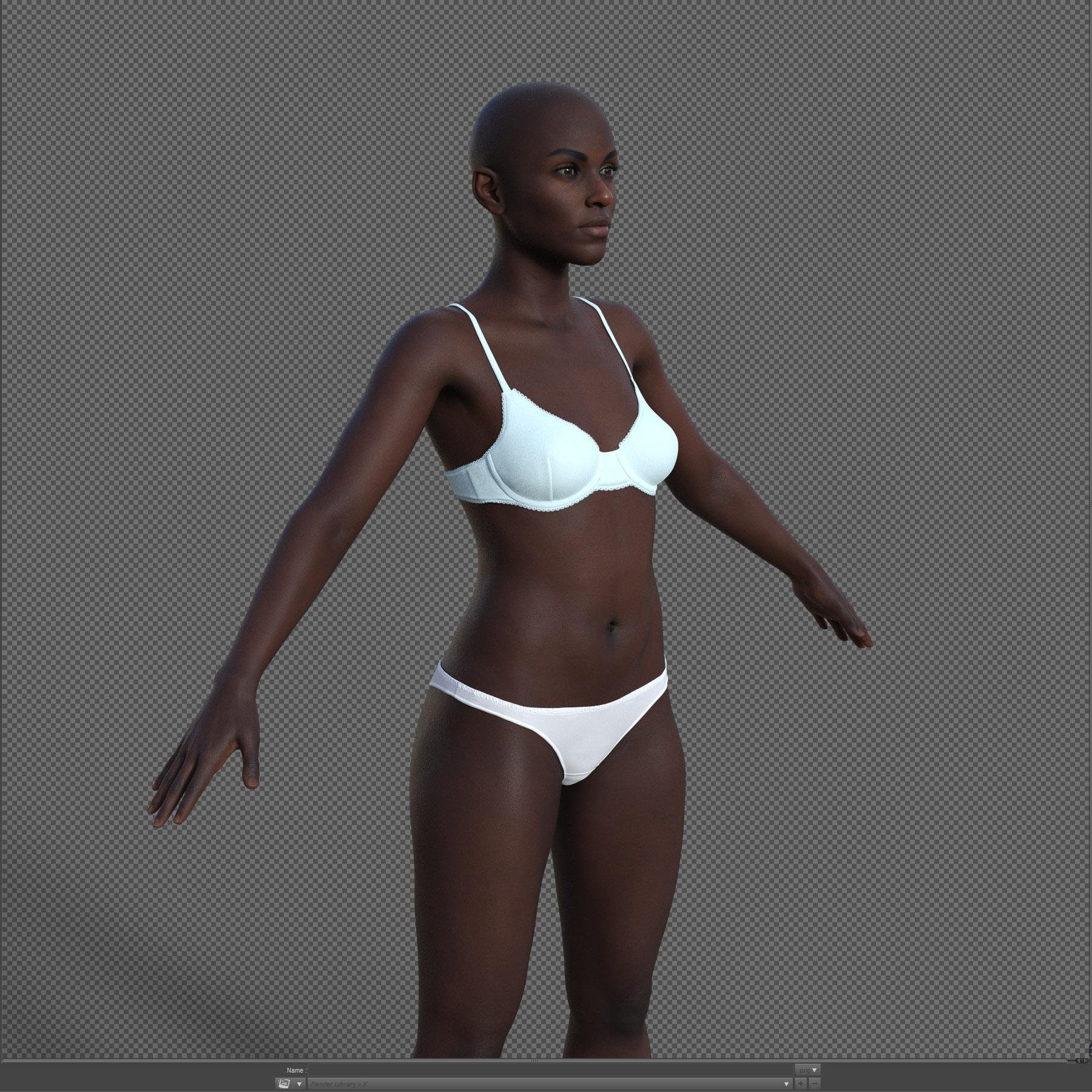

    @Matt_Castle I can reproduce your problem with the PBRSkin shader in the timeline on frames other than frame 0. These attached renders are what I see: I think the reason we see the shader rendered correctly after saving and reopening the scene, is that the character added in a later frame, now appears to have been moved to frame 0. See the screenshots I attached. It would be nice the get an explanation of what is going on and whether this is considered a bug by the Daz developer team.
    Jada 8.1 added in frame 0 and rendered (looks correct)
    Jada 8.1 added 9 in frame 2 and rendered ( looks wrong, no specularity/gloss)
    Timeline when Jada 8.1 was added in frame 2. Her keyframe appears in frame 2.
    When the scene is saved and reloaded, Jada 8.1's keyframe appears in frame 0.
    Frame 0:
    Frame 15:
    Frame 30:
    UltraScenery's custom "UltraScenery Terrain (MDL)" shader instead experiences problems with its tiling:
    My ticket for this was originally on DS 4.21.0.5 (although I'm certain I noticed it earlier), but I can report that it is still completely replicable for me in the latest Beta, and I've since confirmed that other people are witnessing the exact same on their systems (note that if you're checking it in Iray Preview, you may need to come out of Iray Preview and back in to see the change happen), so I'm posting it here in the hope that someone finally spots the report and moves it up the stack for fixing.

  • Matt_CastleMatt_Castle Posts: 3,282
    Okay, that's interesting.
    Testing it, if I load Jada while the playhead is on Frame 0, the bug does not occur. If I load her while on Frame 30, the bug does occur. So I can actually end up with a bugged and a non-bugged version simultaneously in the same scene depending on what frame I was on when I loaded the figure. However, further experimentation with dragging either figure's keyframes around has no effect to either fix or cause the issue.
    That's at least a slightly less ugly workaround (go to frame zero to load the models), but I still want to be able to effectively work on Frame 30 (and have that set in my default scene) so that I have the space available to do dForce timeline simulations. (DS is extremely sluggish about moving around keyframes - the tests I did above with moving the keyframes took a few minutes of the program locking out each time).

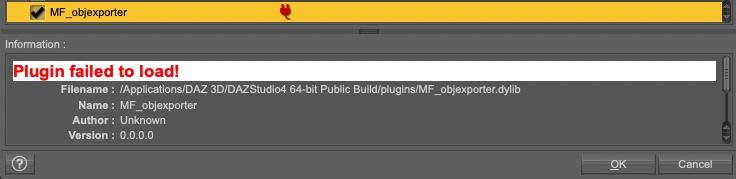

    I couldn't install the latest beta via DIM.  It uninstalled the previous version, but it shows as -1 Bytes in the installed file list in DIM, and on restarting DIM it shows as not installed.  Repeating the installation, and redownloading the file gave the same result.  I ended up renaming the 'c:/program files/DAZStudio4 Public Build' directory and it did install.
  • Richard HaseltineRichard Haseltine Posts: 111,677
    I have seen others with similar issues. The inability to install without manually deleting the folder does suggest permission issues, or security software being hyper-sensitive.
  • WandWWandW Posts: 2,907
    Richard Haseltine said:
    I hadn't ever changed anything in that folder, and I'm not using any third-party security software on that machine; just Windows Defender.
    I had also updated the release version of Studio, and DIM uninstalled it but did not reinstall.   I "uninstalled" it and reinstalled it via DIM and it did sucessfully install...

    G3Renderworks said:
    I'm having a weird billboard issue in the beta. For some reason the billboard looks lower quality and there is a strange redness in her mouth when compared with the stable verison. I used the exact same settings and had no issues although I was using older versions of both installations. So I went ahead and updated both my stable and beta daz installs and my video drivers but it's still happening.
    You're right. That's because of a new rendering param. in Render Setting of Public Build. I found it from another case but I just tesed with billboard props, I got the same problematic result as you had.
    You just go to Render Settings pane, Optimization, set Off or Medium in Texture Compression property.
    With higher texture compression in PB version, that famous "redish" issue will come, so that's why your saw red teeth.
    2560 x 1392 - 962K
    2560 x 1392 - 1M
    Post edited by crosswind on
  • crosswind said:
    Thank you! That was driving me insane.

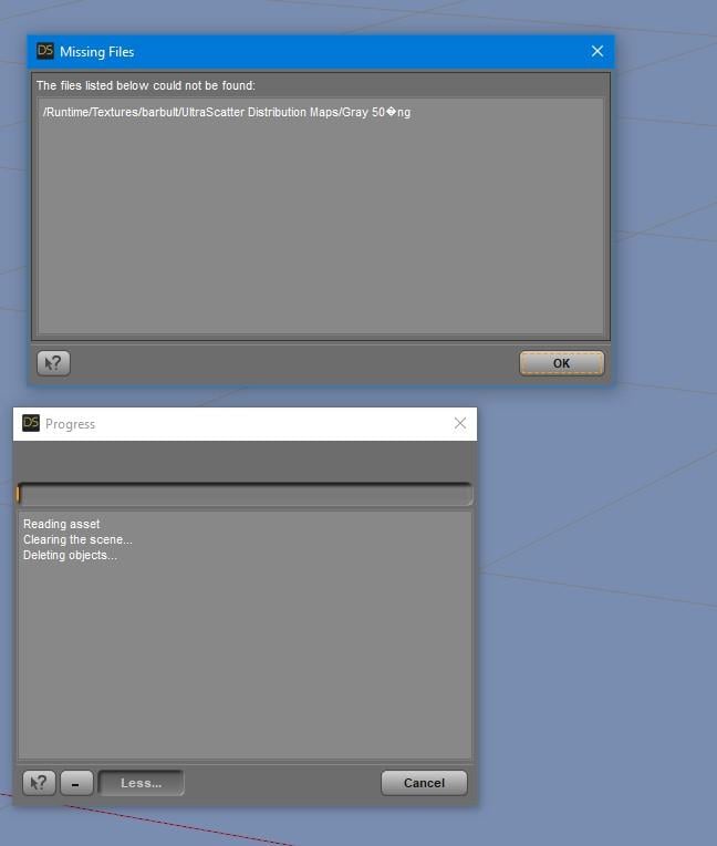

    Some custom shaders used in products purchased in the Daz Store are causing DS 4.22.1.150 to crash. The crash does not occur in the released DS 4.22.0.16.  The situation is strange, because props with the shaders load OK and render OK, but when the scene is cleared up, Daz Studio crashes.
    Two examples of shaders that trigger this crash problem are in the Tropical Botanica - Understorey product. The shaders are "PB Mossy River Rock shader (MDL)" and "PB Mossy River Log shader (MDL)". Sample props in the product that use those shaders are USCT Stone 01 and USCT Fallen Wood 01.
    To reproduce this problem, just load either of those two props into a new scene and then close Daz Studio. CRASH. I have attached a crash log. I am running DS 4.22.1.150 on Windows 10. This problem is 100% repeatable.
    zip
    zip
    DAZStudio_error_report_240605-210800.zip
