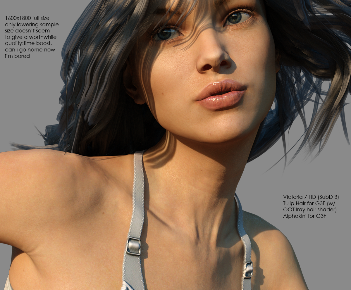

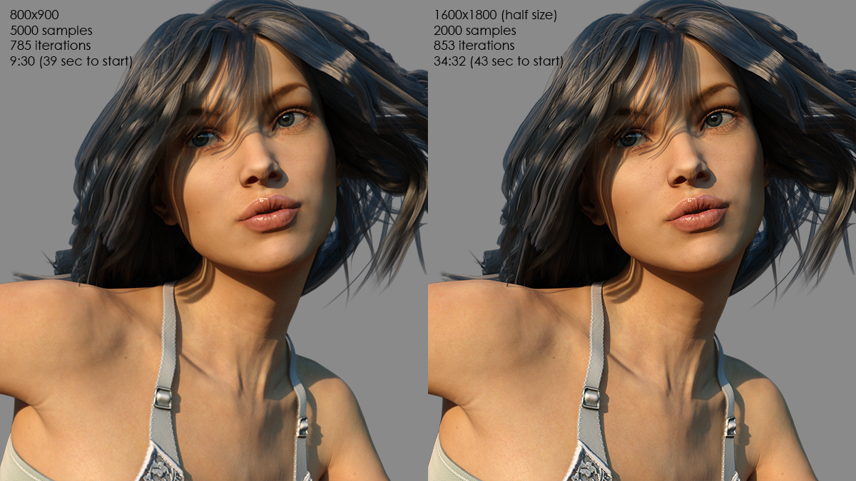

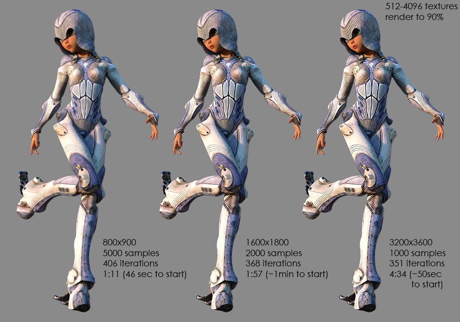

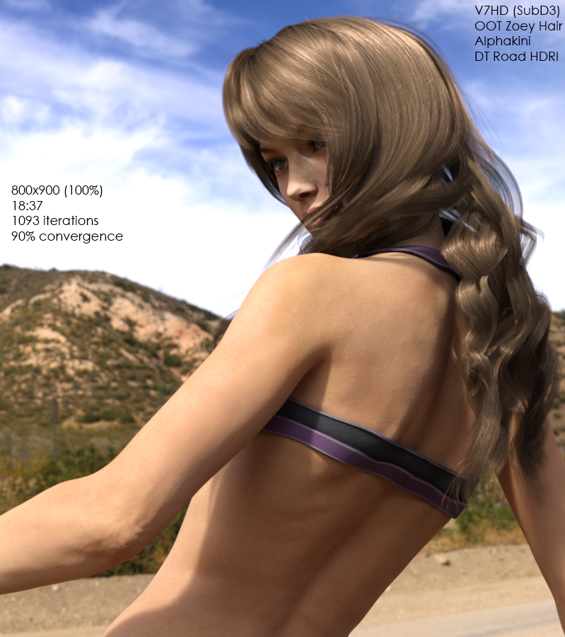

    Okay, I redid the test (now that I think I understand what you meant with the trick.)
    I picked V7HD again but swapped to OOT Zoey hair, since it's the most complicated one I have and absolutely murders my renders.
    Details explained on the images. I think that going up to 1600 gave a significantly sharper result, but 3200 gave no further improvement over the same timespan.
