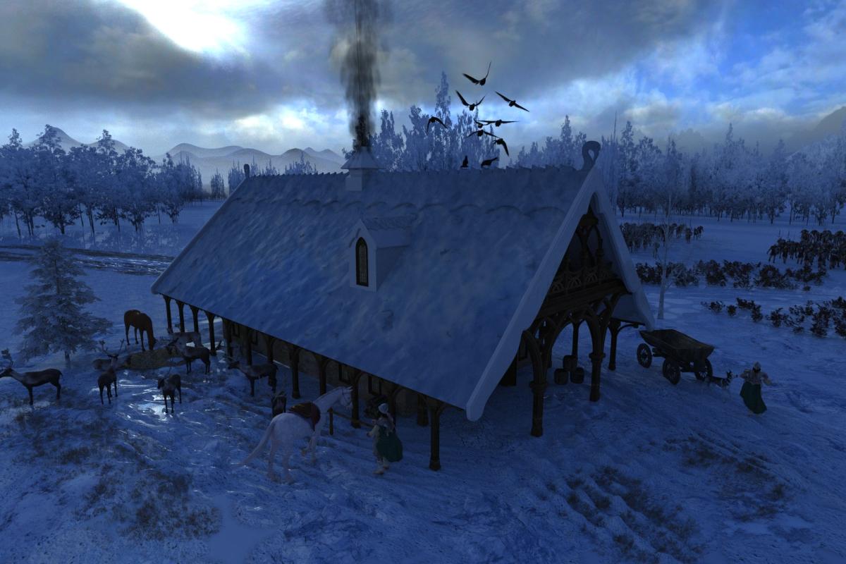

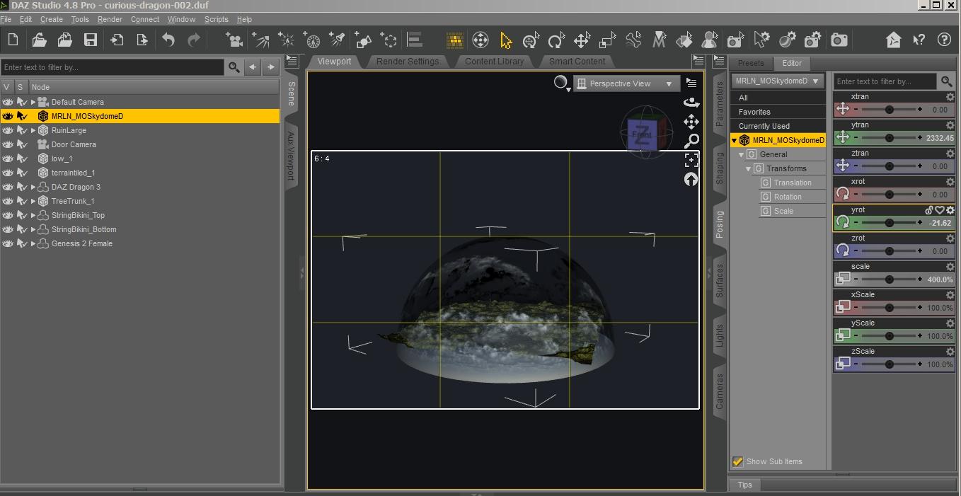

    You can view the dome if you take the camera outside of it. You can see where the sun is on the image, scale it to fit around the objects, raise it and lower it to get the clouds to show where you want them. This one is transparent as I am using Sun and Sky Only in the render and I want the sun to shine through it.

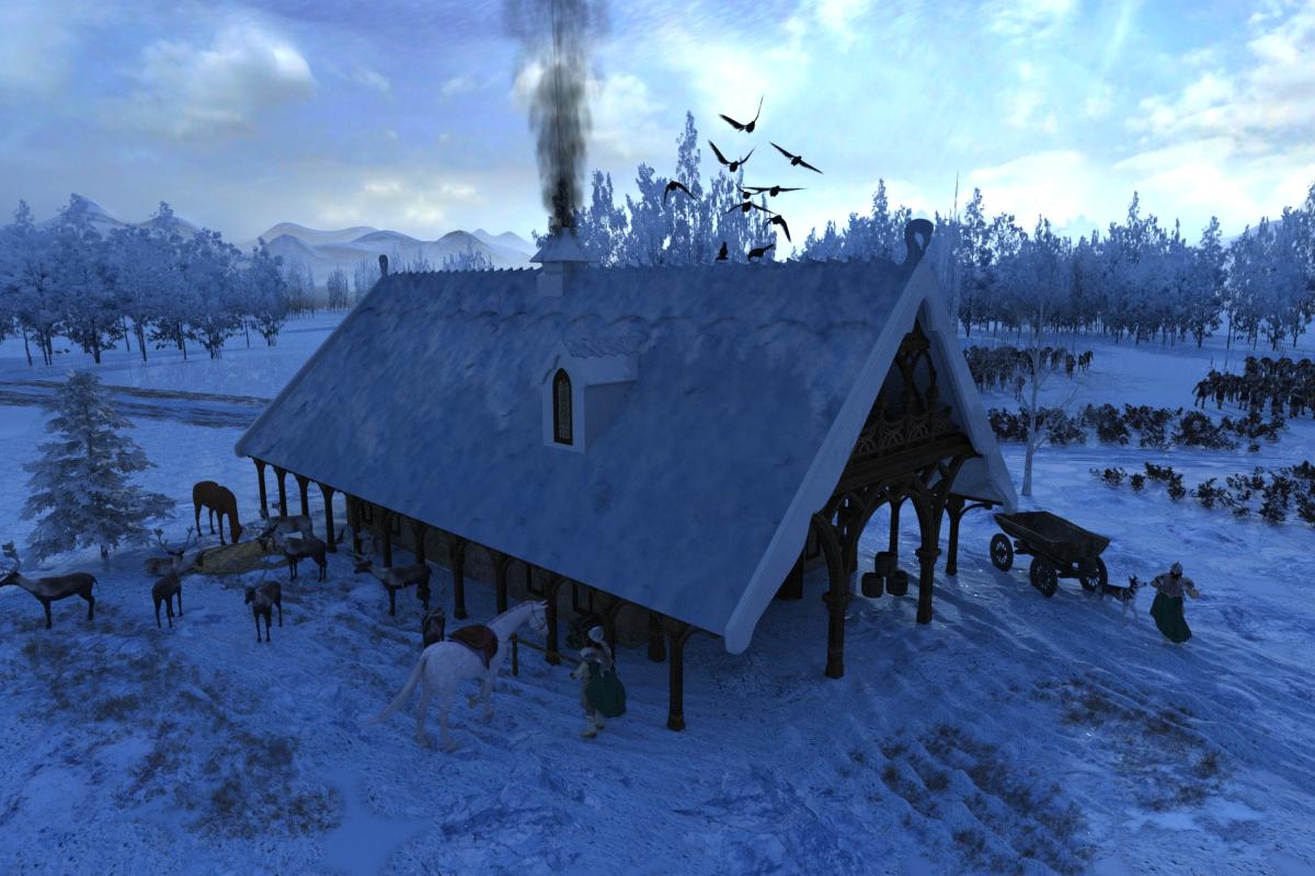

    I like the idea of using translucence on a geometry dome to add atmospheric effects to a 'Sun-Sky Only' environment mode Iray render. But I'm not so sure about using a full 360° azimuth / ±90° elevation environmental map on a geometry sphere in the same way - if your horizon undulates above and below the 0° elevation I'd expect to see some problems in that area since the sun-sky lighting has a distinctly horizontal horizon ?
    This was only a test render but you can see the clouds in the sky which is the Skydome by Merlin I think.
    1200 x 800 - 939K
