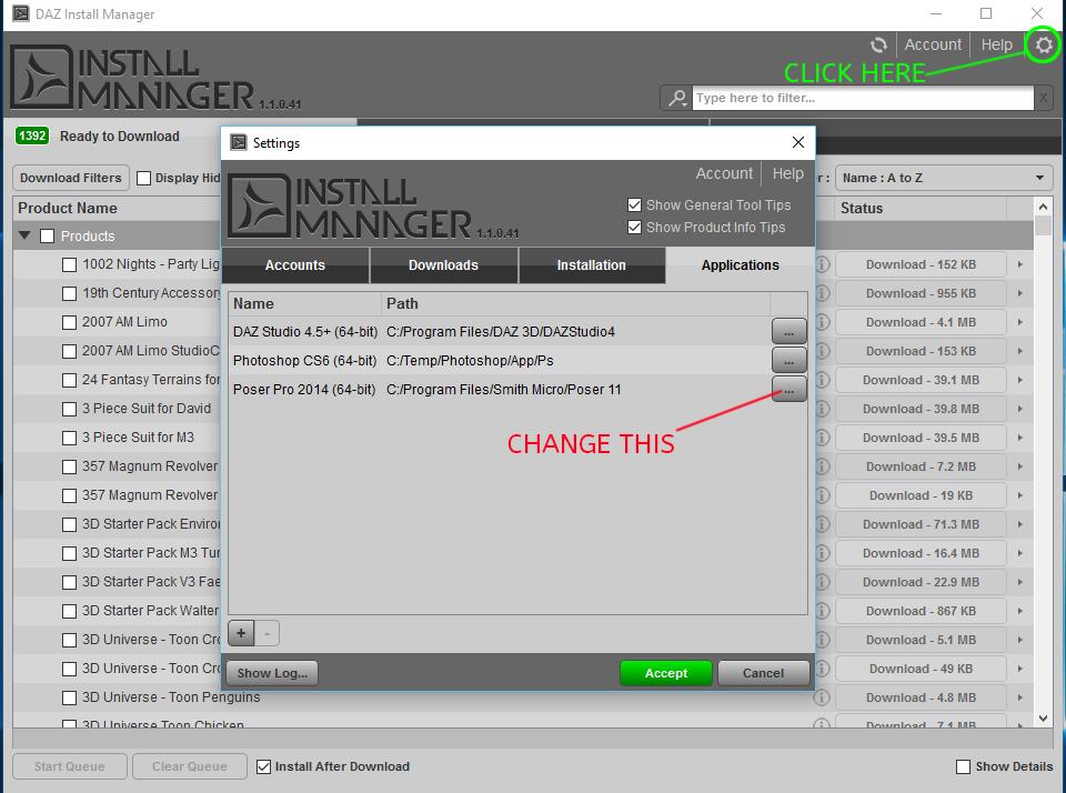

    How do I set the path - is it for applications in settings - I do not see how I can direct it to Poser 11/runtime as poser /2014 runtime? Maybe I'm just dense but I cannot rename the runtime? Maybe I'm missing the point - I often do.
  • Midnight_storiesMidnight_stories Posts: 4,112
    edited December 2015
    For DIM
    960 x 714 - 354K
    Post edited by Chohole on
