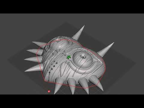

    Did a comparision of Meshlab and MeshMixer both of which I have installed on my Graphics Computer
    Meshlab
    Edit - Select Faces in a Rectangular Region
    Filters - Quality Measure and Computations - Compute Area/Perimeter of Selection
    MeshMixer - could not find anything obvious for Surface Area, mind you I am only using the program for the first time
    1923 x 1043 - 130K
    796 x 766 - 121K
    Post edited by Bunyip02 on

    Thanks Wendy !!! Not an obvious place to hide it !
    798 x 770 - 101K
