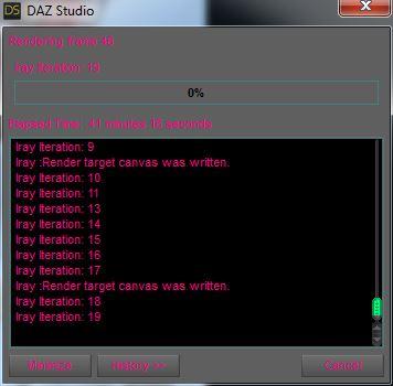

it goes smoothly 30 secs a frame ( I limited samples and time) then just stops, I have no idea why
has happened twice now on DS4.9 beta
I cancelled and attached logfile
repeats this
Iray INFO - module:category(IRAY:RENDER):   1.4   IRAY
rend info : CUDA device 0 (GeForce GTX 980 Ti): Prevented
device timeout

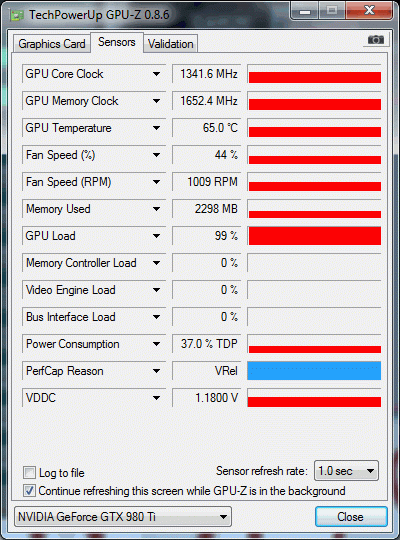

  • RuphussRuphuss Posts: 2,631
    edited November 2015
    it says gpu load 99%
    memory used 2298
    your card has 6 GB ?
    somethings wrong here
    the GTX 760 you are also using
    can it behave as a bottleneck ?
    what is shown on the first side of gpu-z as memory size ?

  • Well I disabled the 760 in Iray
    it is only used in Octane in DS4.7 as I will not pay to upgrade the plugin
    I sometimes use it in Carrara octane if load below 2GB as easier to do on the fly for extra cuda cores but on GPU-Z in iray it is zero
    as I said it renders fine until 48 frames
    I am now redoing my render with. HDRI no cyclorama mesh or grass and its still going at frame 87 as I post

  • WendyLuvsCatzWendyLuvsCatz Posts: 41,695
    It stops now at 88 frames after applying iray uber shader to all surfaces
    just the fox with rigged fur renders all 800 frames
    and it fits on my 760 in DS4.7 Octane render 1.2 so not a size issue card wise
    the fact it renders frames before stopping to me suggests DS 4.9 is accumulating data somewhere as it goes a memory leak
    the last image is DS4.7 Octane frame 90 and still going fine
